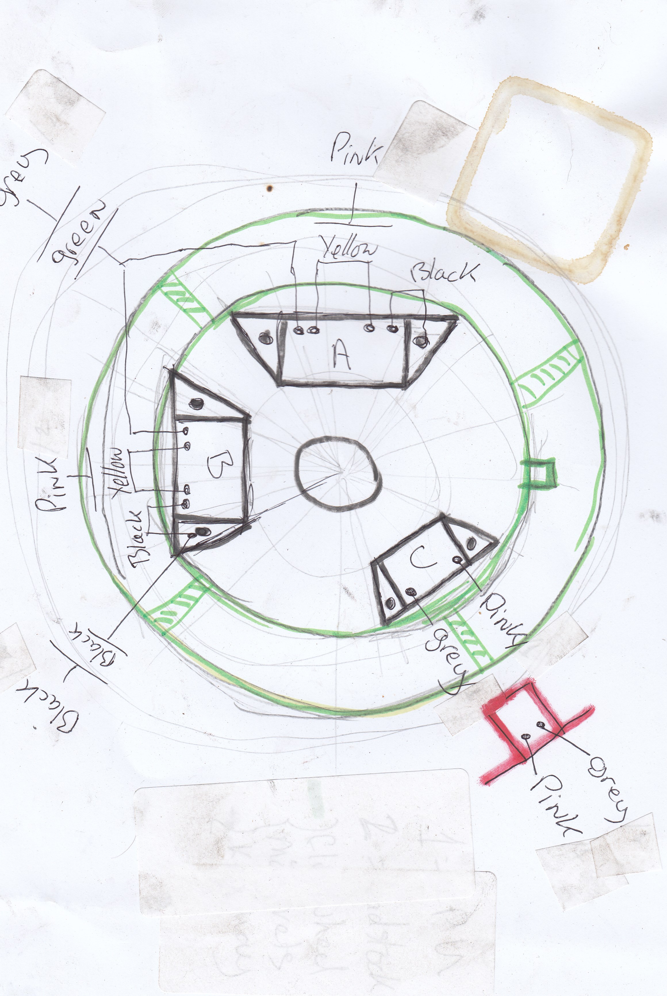

john brooks Posted February 1, 2017 Share Posted February 1, 2017 Hello. I am John and live in mid Wales uk, I have been a precision engineer for 35 years and have run my own company for the past 6 years. J P B Creative Engineering ltd, I work on anything from high end spiral stair cases to welding up rally cars; I have a reasonable kitted out work shop in the hills of mid Wales. Please look up my post code SY175RR. I work alone as a engineer but also employ and train some of the local teenagers during the summer, setting up large stage work for arenas and festivals. I have a stolen and recovered dt125 that i have rebuilt for my son but am stuck on the set up from the stator to regulator. Please see attached picture and any advice would be great as im lost. Best regards john the coil next to the tdc censer also power the ecu and give power for the spark but the bike do not run right. the ecu needs to be connected to a battery as well. but as I said I cant see how the other two coil work or witch regulator to use. 1 Link to comment Share on other sites More sharing options...

Moderator Airhead Posted February 2, 2017 Moderator Share Posted February 2, 2017 Hi John, did you draw it wrong or are the coils really mounted the wrong way round? Link to comment Share on other sites More sharing options...
blackhat250 Posted February 2, 2017 Share Posted February 2, 2017 The 3 coils = 1 Soarse coil/ 2 lighting coil /3 pulser coil/ , never seen Grey wires, its usually Green/white [ charging] Yellow/and white [lighting,] - red/white [ pulser trigger] . how many wires on the CDI, ?. AND IS PICTURE OUT 180 DEGREES, Link to comment Share on other sites More sharing options...
