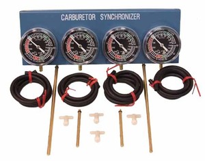

Ok folks just a quick idea here. So been meaning to balance the injectors on the FJR since I put it away, finally got round to it and stuck the balance tubes on the little tit things and merrily started to balance it all. Will it f**knig balance out NO! go through the procedure again and reattach all the pipes and make sure the right pipe is on the right tit then check to see if the gauges are working ok still won't frigging work. Finally get round to checking the ends of the rubber pipes that connect to the bike (running out of things to try at this time) find that the rubber is stretched just enough to let air in thus messing with the balance calculations, so chopped 1/2 an inch off the ends,  seems that if you use these things on different bikes with different sized attachments and it's cold enough to freeze your nuts off, the rubber stretches just enough to make a real difference. So if your going to do this during the dead of winter check for a TIGHT fit before you launch into this balance palaver. Just thought you could save yourself an hour of fruitless fault finding and swearing!
Stay safe.
I'm not sure what set you have, I have the cheapo ones with 4 gauges mounted on a blue/green steel plate. The gauges are decent enough, but the hose supplied with them was utter rubbish. I replaced my hoses years ago, after it perished away to nothing.
Yep that's the ones Pilninggas utter frigging rubbish, thanks for the tip Drewpy will get some asap.
Yeah it's amazing when you think your saving a few quid to find out you might just have well spent the extra money and bought something that didn't fail, the gauges are good tho.
Related imageshould have bought these instead Related image
Used the cheap arsed blue ones for years, grabbed some rubber hose out of a couple of scrap rangie's in a breakers (they had really long hoses the right size for the cruise control, literally 6feet long) Then the unit can hang on the wall while your balancing the carbs out of harms way. They did my old Suzuki, 2 of my mates bandits and they are STILL doing solid service balancing my neighbours hornet and the GSXR400 a guy at work uses as his daily driver.
Granted you get what you pay for and the carbtune is good but is it that much money better. Nah it doesn't do anything more.
