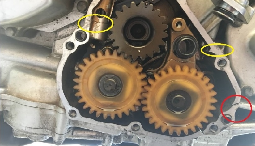

andrew_oc42 Posted October 23, 2016 Posted October 23, 2016 Hello, Just wondering what options I have for engine replacement or repair for my 99 TDM 850? As you can see from the photos attached, there is a crack in the engine.. It appears that it's only in the bottom block. I'm finding it hard to source a replacement engine. I'd much rather just bolt out, bolt in if possible, however it isn't looking likely. Is the TRX850 the same engine and interchangeable with the TDM850? If not, what are my options? I bought this bike as a project with the intent to rebuild. I haven't had it started at this stage. After attempting to start it, the starter relay clicks, however the starter doesn't engage or turn over. However the wiring in the bike is horrendous and will require a new loom, so I'm assuming this may be some of the issue. Thank you, in advance Andrew. In this photo it shows the crack with the casing off, which goes right through. (in the red circle) In the yellow circles, it appears that this is the separation point for the top and bottom of the block. Are there any suppliers that make this, or would it be easily accessable? Is there anything I need to look out for especially for my 99 tdm 850? Thankyou.
Tommy xs Posted October 23, 2016 Posted October 23, 2016 I don't think the trx motor would fit straight in as it has almost dummy second cylinder which contains the airbox, also think the trx motor might be even harder to find. Your best option is probably a dona tdm, keep a look out for one on eBay you should pick up a project or winter hack really cheap this time of year
slice Posted October 23, 2016 Posted October 23, 2016 First thing I would like to know is why did it crack in the first place? Your going to have to fix that then I would look at getting the thing welded rather than replacing the whole engine. Yeah it looks horrible but are you positive it can't be repaired? Unlikely to be a stress crack it looks like something external hit it and that's what broke it in the first place, probably dropped on it's side so if that is the only damage it would be cheaper to repair it than hunt round for an engine that might be a dog as well. Look for an exploded diagram of your motor and see if the part that's broken is removable then decide where you want to go with it! PS DON'T even think about starting it till you have replaced the damaged part, you have no idea what else is stressed out till you get it apart. 2
pilninggas Posted October 23, 2016 Posted October 23, 2016 The TRX850 motor does fit - but they are rarer than 4TX engines. it a difficult call, that's looks like a split crankcase job. I'd be inclined to try to find you local automotive engineer and ask their opinion - sometimes they have kit and techniques that allows them to perform repairs to cracks and breaks without tearing the engine down. 1
Moderator Cynic Posted October 23, 2016 Moderator Posted October 23, 2016 I agree, also after being caught out buying both car and bike engines over the years, rebuilding that one is a better option. There is no guarantee the replacement engine will be any good long term, it could come with hidden problems or god forbid be from a stolen machine. Stripping that one and fixing it will in the end be the best option, even if you end up needing a lower case that would be a better bet from a breakers than another motor. 1
Tommy xs Posted October 23, 2016 Posted October 23, 2016 Is an option but he doesn't know the history of this motor either it could be goosed if its been run in that condition who knows what damage lies within
Moderator Cynic Posted October 23, 2016 Moderator Posted October 23, 2016 He knows this one is goosed. So tear it down and see how badly then rebuild. Twice in the past, one a v8rover and a 350 powervalve that were running sweetly etc. Heard both running. Neither lasted more than months because of deep down problems. Working out the cost of pulling the motor again and then spending top dolla for gauranteed unit in the case of the v8 i would have been better off fixing what i had.

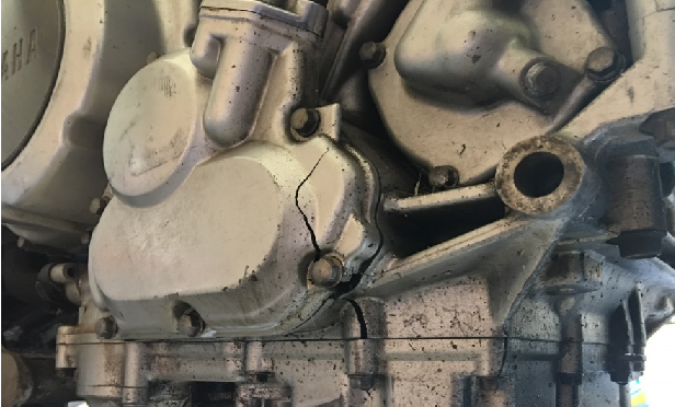

andrew_oc42 Posted October 24, 2016 Author Posted October 24, 2016 Thanks for all of the help thusfar! After a little bit of cleaning and investigating, I found another hole in the engine.. Please find attached photos. Is this also the bottom end? or top end? It appears to be the top from what I can see. Is this also able to be welded? I've found a top and bottom end located in Germany, however I'm in Australia. Would it be worth the freight, or would welding be sufficient? These are apparently for the 4TX. Thankyou for your help, its greatly appreciated
Moderator drewpy Posted October 24, 2016 Moderator Posted October 24, 2016 check the engine number, 4tx should be in there
slice Posted October 24, 2016 Posted October 24, 2016 That's what I would do if your able to find the part, anything can be welded but it does look like it's had a bit of a hammering. Work out the cost of welding against buying and shipping then make your decision. Don't go off half cocked and buy something then find out 3 weeks later that a repair is going to cost a third of the price. No engine is beyond repair it's just the cost that decides whether it's worth it or not. Don't forget with a new part your going to have to buy all new bearings seals and gaskets as well, it all adds up.
andrew_oc42 Posted October 24, 2016 Author Posted October 24, 2016 Thanks for the reply. It will cost me approx. $250AU to get the top end and block here and I can have it in approx. a weeks time. Still waiting on a quote to get it welded and rebuilt. Such a headache!
slice Posted October 24, 2016 Posted October 24, 2016 Fingers crossed mate it will get worse before it get's better.
