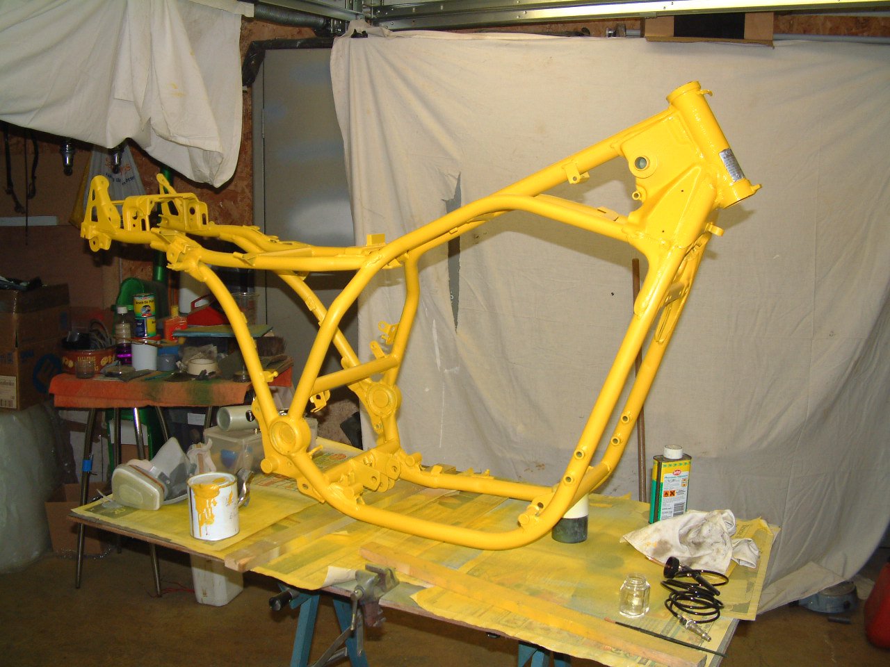

Personally, i think powder coating on frames is way  overrated, its way too thick, cannot be touched up, and is a pain in the arse to tap&die all the threads or find nuts and bolts for them. All my restos now get sprayed the ''old fashioned way, here its no more expensive than powder-coating, and you get to save vin labels etc and you can still see the stamped vin #s, which seems to virtually disseapper when powder-coated.
I disagree, I've just touched up my wheels on the FZ when I changed disks I get the RAL number off the powder coater.
Paint in the UK is very expensive compared to powder coating (Paint is labour intensive). A specialist powder coater won't lay it on too thick and preserves the stamping.

Sorry Drewpy but have to agree with Anyoldiron on this, powder coat is a pain in the arse when it comes to torque settings, I did my XJ with a gun and it came up really nice, but your right about the cost of paint,  My paint was £90 a half litre and then there was the cost of under coat and clear coat to consider, total was about £190 but had the satisfaction of doing it myself. Mind you tho it did have a total of about 20 light coats of paint when I finished it.

I think it depends on who does the powder coat, I had my frame done at a steelwork company and it was way too thick in places. Plus I lost my frame number etc. However the guy that did my engine cases is a bike nut so I'll be going to him from now on
