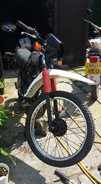

Hi All,
Finally got the box of bits project looking like a DT50MX with my boy - sourced a NOS loom on ebay so ghould be roughly ok? but no spark - No neutral light and wire has snapped off under casing so got to reconnect that, but does the neutral light blowing stop it sparking? It is a 1990 points model - is the points gap crucial to even get a spark?  Was cock a hoop when got a beep from the horn and front indicators flashed so done something right :D It looks a bit like this  but headlight on now.sam's bike incl front end.jpg
Panic over - the points were past it and new set did the trick - bypassed whole loom with direct LT wire to coil and it worked. Ignition is wired correctly and kills the engine - It ran!!! Carb leaking though and timing may not be perfect. I need new bushes for rear shock if anyone knows where to look? It defo lives and I am loving it
