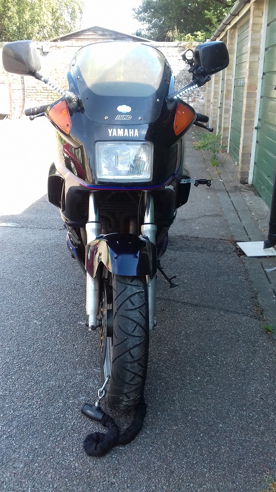

Sorted! Bumped into a decent bike mechanic by chance at a bike meet near me who used to run a bike shop. He discovered it was only running on 3 cylinders (!), checked the plugs, spark, compression test, adjusted carb mixture (carb number 4 screw had been turned out 4 times, hence why she was guzzling fuel), and synced them all for £30 and now she goes like rocket! He did give me a bit of a bollocking for not riding with my lights on in the daytime and keeping it in too low revs before changing up a gear, he said on the open road don't change up until it gets to 6000rpm when accelerating.

On a different note I've noticed when I close the throttle or use the gears to slow the bike down there sounds like a bit of backfiring or popping sort of like the 2 strokes of the old days - but not when you accelerate. Is that normal? Having only had bikes with one cylinder before this is new stuff to me!
Backfiring and popping could be a sign of a hole in the exhaust, or possibly fuel mixture is off...?
Get the tank off and check the carbs are balanced. It's piss-easy on an FJ!!
The carbs we're only balanced two weeks ago so guess it's fuel mixture - do I need to turn the screws in or out?
Yes, you can get a double-bubble. It's sort-of square and kinda odd. There is also a touring screen with higher and more curved lip. However, the screen is shaped as it is so you can get your face down against the clocks and nail it, which also helps keep the wind and rain off your lid... not that I've tried, heh heh!!
Carbs: http://www.fj1200.info/mixture_screws.htm
