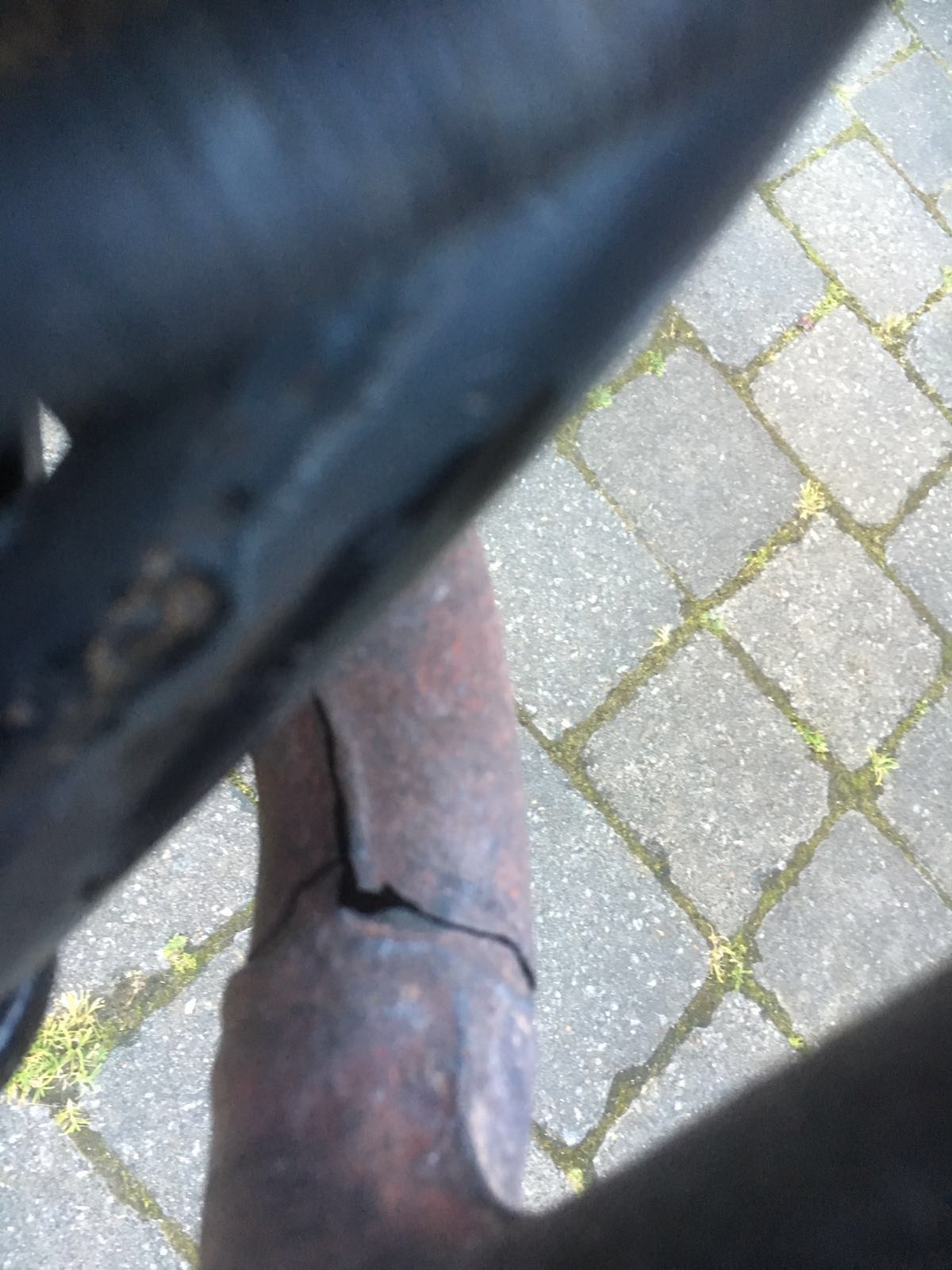

Yesterday I started it and noticed that it was much louder, sounded like the exhaust blowing. I unwrapped the exhaust tape to unveil a gaping crack round the exhaust where it drops and bends out of the engine.

Hahahhahh, you have discovered the physical definition of 'rare as rocking horse shit'.
They come up but rarely and at gold plated prices, there are pattern ones on e.bay but they have a layout more typical of the later 125lc instead of the long thin expansion chamber of the original. they also , disturbingly seem to be chromed. Why a dirt bike would want a chrome pipe beats me but its a good finish to sand and paint I suppose.
It may, if its an original pipe be worth getting it repaired by a decent metalworker.
Oh and the 125 is identical to the 175 as far as exhausts go. So long as its an MX. The earlier ones don't fit.

I assume these are just prone to rusting and breaking in these places, due to it being a U bend and the shaking stress.
Wow, that looks to be solid. I found one for 300£ yesterday but wanted to ask in case I was about to pay way too much.

IMG-20160717-WA0004.jpgI did consider taking it to a welder, I thought by the time they had done, it may cost as much as buying one. The crack goes all the way round the tube.
Maybe I should buy one for now, as I shouldn't ride it like that. And see if someone could repair it for a spare or to sell.
