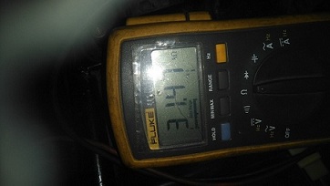

So as it stands, i have a fully charged battery reading 6.2v. When i start the bike and rev her up, the voltage reading stays at between 5.8v and 6.2v with the battery connected. As far the the guides an gurus on the internet are concerned, I should get up to 8v on the battery when the motor is running. When i remove the battery, i get a fluctuating reading on my multi meter, between 1v and 2v across positive and negative in the loom where it connects to the battery.

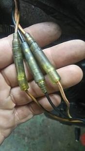

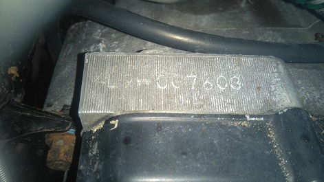

Out of the magneto, i have wires joined with a proprietary connection. The colors are brown, blue and yellow. Then there are 3 wires that connect with insulated bullet type connectors. The color are white with a red line, black and brown.
