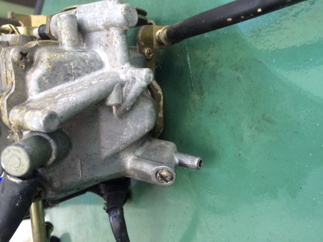

On the bottom of the float bowl you should see a Philips head screw up inside a socket arrangement at the base/side of the bowl, CAREFULLY find the right screwdriver and remove said screw from the housing, the fuel should flow straight out, if not then you have to take it apart as it's blocked with crud. You can run a thin wire up the hole and wiggle it about to encourage the fuel to flow but all your doing is moving the crud around inside the bowl and it will bite you on the arse if you don't drain and clean it.
I guess I'm finding some of my own answers along the way - I suspect that this is the carb drain, bottom left? Whatever it is, it is seized solid and the head partly stripped (as are two pan-head screws on the piston cover)...
Hi Slice - just missed your post.
I suspect I will have a bit of trouble with this one... :(
Ah, well... that's what weekends are for.
Yeah that's the bugger, usually pretty hard to get out, which is why I said find the right screwdriver, if you find one that fit's perfect then they will come out if you try with any old thing your almost bound to strip the head off. You have a cross cut AND a straight cut screw on yours so a decent straight screwdriver will get it out easily, heat is your friend here, hot air gun (paint stripper) heat it and cool it a couple of times, hot then dunk in cold water and it will pop out easy.
