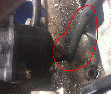

Thank u, today new problems.. on this hose fuel is leaking, it just keeps going from thatScreenshot_2.jpg hose, but when i close it bike wont go.. and thisScreenshot_3.jpg is closed with something inside..
if the hose is the overflow then you need to check the float valve, it must be passing fuel when it should be closed, inspect it and clean it if it's dirty or replace it if it's worn/damaged
don't know what picture 2 is I wouldn't do anything with that!
  • Like 1
Thank you man, i cleaned it and now everythink is ok, bike runs and drives great.. everything is perfect..
