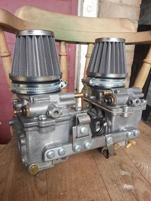

Been stripping them down over about a week or so, left them to soak in a bucket of acetone for a few days, and been tidying them up with an old toothbrush, scotchpads and gun oil 'borrowed' from the armorers (used in conjunction with the scotchpads it's almost as good as autosol, brings them up a nice bright flat shine). Needless to say most of the original fasteners were partially rounded and looking generally tired, luckily during my ventures into the local town i came across a random DIY store, which sold individual fasteners, a whole new set of A2 Stainless fasteners and spring washers for both carbs and bracket cost me less than 2 euros... so about £1.20, most of that was buying a packet of 50 M4 spring washers which they didnt sell individually.
they are still a long way from being finished and there are nooks and crannies which i cant quite get at, but it keeps me humble and satisfies my cravings for something mechanical to occupy my time.(the management have already cautioned me about trying to bring another bike home, afaik TURD is still out in america in a shipping container).

Came up alright, got a set of cheap-o pods for them to make do until i can find something more suitable
