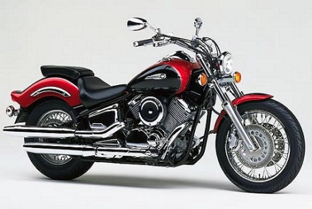

Having owned my XVS for just over a month now, it's time to start making some changes as I'm not a fan of all the chrome, so am after some guidance really as to how best achieve this without breaking the bank...if that's possible!
I'm unsure about how to modify the rear. I'd like to get rid of that horrible huge back mudguard (or fender as some prefer), and replace it with something smaller and lower in gloss black. My girlfriend sometimes goes on the back, so I'd like to retain a neat pillion seat of sorts, just not the studded YMCA cushion and sissy bar it has fitted at present! If I can find something that's easy to swap so provides a seat for her on the odd occasion, but then comes off and has no pillion seat to give a bobber look, then even better. Any suggestions?
I'm thinking I'd also like to go with a side-mounted licence plate, small black indicators, black mirrors and different handlebars (although I've no experience of dragbars or ape hangers). I might also move the foot controls forward a few inches.
This is how she currently looks:

Im not too sure on how the rear mudgaurd is mounted to the 1100, "i think" is a metal cage similar to the set up on the XVS125. If this is the case to do the swop as you want then this cage will need to be chopped off, a new mounting braket fabricated and welded on or as per the video just weld the mudgaurd direct to the swing arm. If you want the girlfriend to ride then you will need to create a fanny pad thats not fixed to the mudgaurd unless she has a steel spine.

No "easy" swap. The easy solution is ditch the sissy bar (4 bolts), see if you can find a replacement pillion pad on ebay that doesn't have studs on it, and possibly respray the rear fender gloss black. You might also want to respray the tank and front fender the same colour as well. Alternatively, instead of painting the rear fender, get some saddlebags to partially cover it up. They'll look cool (remember, no studs, or conchos!), and they'll be practical as well.

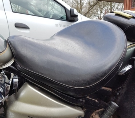

Yours is the custom, so I'd go with that. The one you have on now looks more like the classic, being  a bit more plush. Your main seat is also off of a classic, the custom is a bit narrower and less padded. Not as comfy but looks nicer.
Just start with removing the sissy bar. That should provide an immediate improvement in looks.  I don't actually have anything against sissy bars as such, but yours is just a bit too tall and gothicky! You could also remove the pad for now, and see how that looks.
Well I've bought a Custom pillion pad off of ebay so that should be here soon.
Regarding what you said about my main seat looking like it's from a Classic...I thought you might be onto something so I spent a while on Google images trying to compare the differences. I 'think' my main seat is standard though as I eventually found the photo below (but I could be wrong):
By luck a guy a work who has a Classic brought it in today so I took a photo of his seat. It looks different to mine, so does this confirm mine is a standard Custom seat?
Hmm, I could have been fooled by the angle of the photo.
