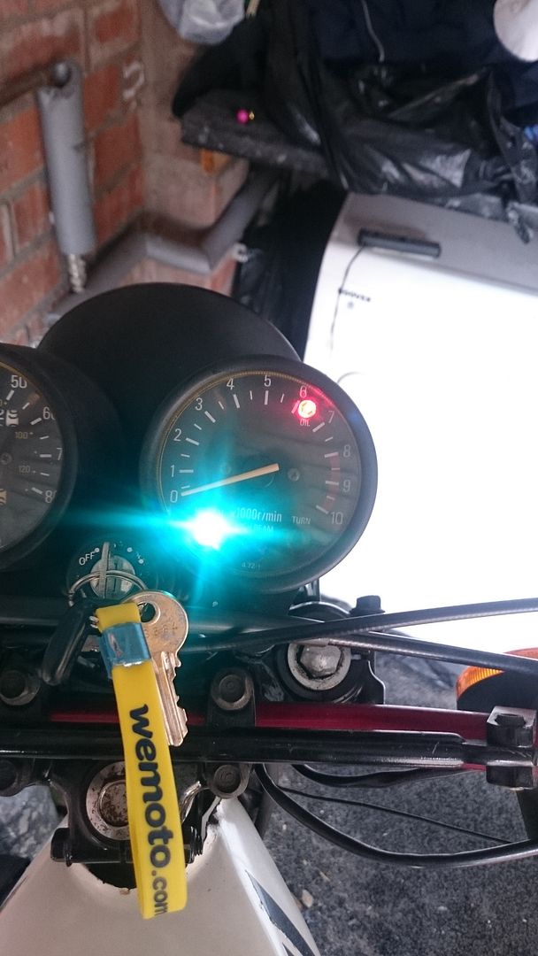

Trying to find every last available mA on this system replaced the neutral bulb which has turned silver again with an RS 209-428 as a test before doing the others. Will have to see what the indicator flasher unit will think of it in due course.

Otherwise good work. Have led's in my tdr250 idiot lights. With a relatively dim one for main beam as i got blinded by the damn thing. (Live out in the country so lot of dark riding).
Prob best leaving the indicator as a bulb. Unless you fit 2 led's in the same housing one for left the other right.

I can now confirm that the led idiot light will not illuminate on the flasher cct. So 3w incandescent bulb for that one!
