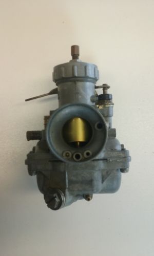

Finally got some free time to mess with the enduros. Had to take the carb off the AT1 as it wouldn't run without the choke on. The pilot jet was clogged so that was the issue, but after reassembly and warm up it was very boggy on the low end. Quickly lost power going uphill and had to continuously downshift. If the revs dropped below about 2700-2800 it would bog down rapidly until downshifting and getting the revs back up.
The main jet is a 140, and the online parts shop lists sizes from 140 to 200. I bought the bike in Denver so it was already living at the higher altitudes, and I suspect the PO put in the smallest jet listed. So is it possibly too lean? The needle is on the middle clip setting, so I can try changing it but I understand that it is more for1/4 throttle and on.
One more q: in the pic of my carb shown here, the hole on the right at the 5 o'clock position leads to the fuel tap for the choke, but doesn't seem to go all the way through. I tried several of my carb cleaner probes but nothing would go all the way in. Does anyone know if this is a blind hole? If not and it is, in fact clogged, that would be part of the problem. Thanks everyone and Happy New Year!

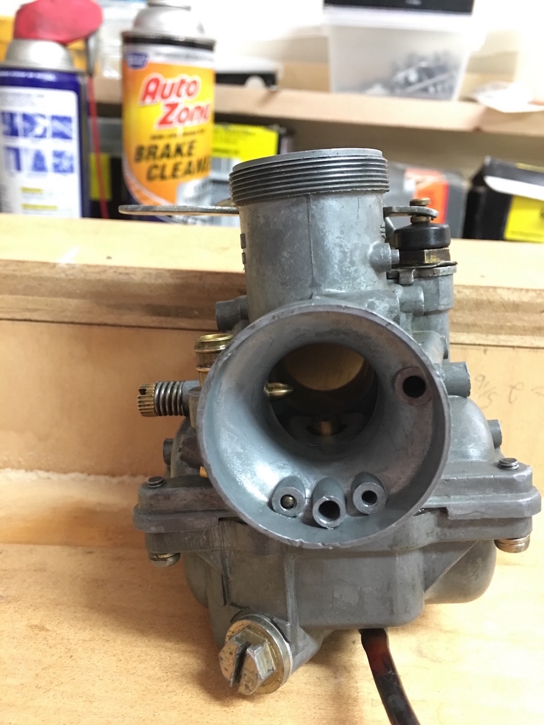

Hey good to see you:wavey: Flybee,. whats the plug colour saying with all this jetting malarkey ,  ,  ,,  not shure what hole is the  AIr bleed,
I'll pull the carb back off and take some pics. As for the plug, it is darkish tan and dry. And this is on the AT1/ 125. And to be clear, I have yet to malarkey with the jets!:P

Okay, bizarre behavior on the site with pics since I last visited, but got it done. Was finally able to get a good view down the bore at about the 5 o'clock position and it does look like a blind hole on this model Mikuni. I have a spare and they are the same.
Replaced the 140 main jet with a 150 and dropped the needle one notch leaner, plus emptied the old gas and put in fresh. No extra pilot jet so it is still stock. Seems a little better but it may just be our old nemesis, age. I think I will remove the motor and start a core rebuild with all new crankcase seals and bearings, maybe go to oversize on the piston. Biggest issue I will have is I now live in an area with even fewer prospects for bore jobs and the like. Only 3100 miles on it, so maybe just new rings.
