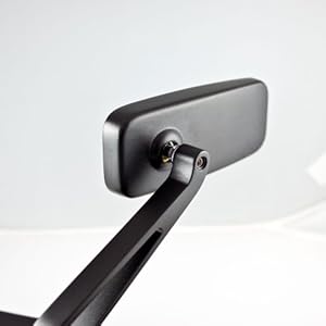

Hi Clive, Don't know your particular bike but most mirrors have a ball and socket connector at the top lower base of the mirror for adjustment, I think your talking about the actual mounting bolts/nut's for your mirror, might be wrong but you usually just grad the mirror body and twist it to where you want it to be, they are usually fairly stiff cos you don't want them waggling about when your riding the bike.
416Nojb7OKL._SY300_.jpg something like this one, see the connector going into the back of the mirror body, yours might be completely different of course but this is how most of them work. Hope that helps mate. Thinking about it if it moved when you knocked it it should move back to the original place by just grabbing it and firmly tweaking it to the original position.
