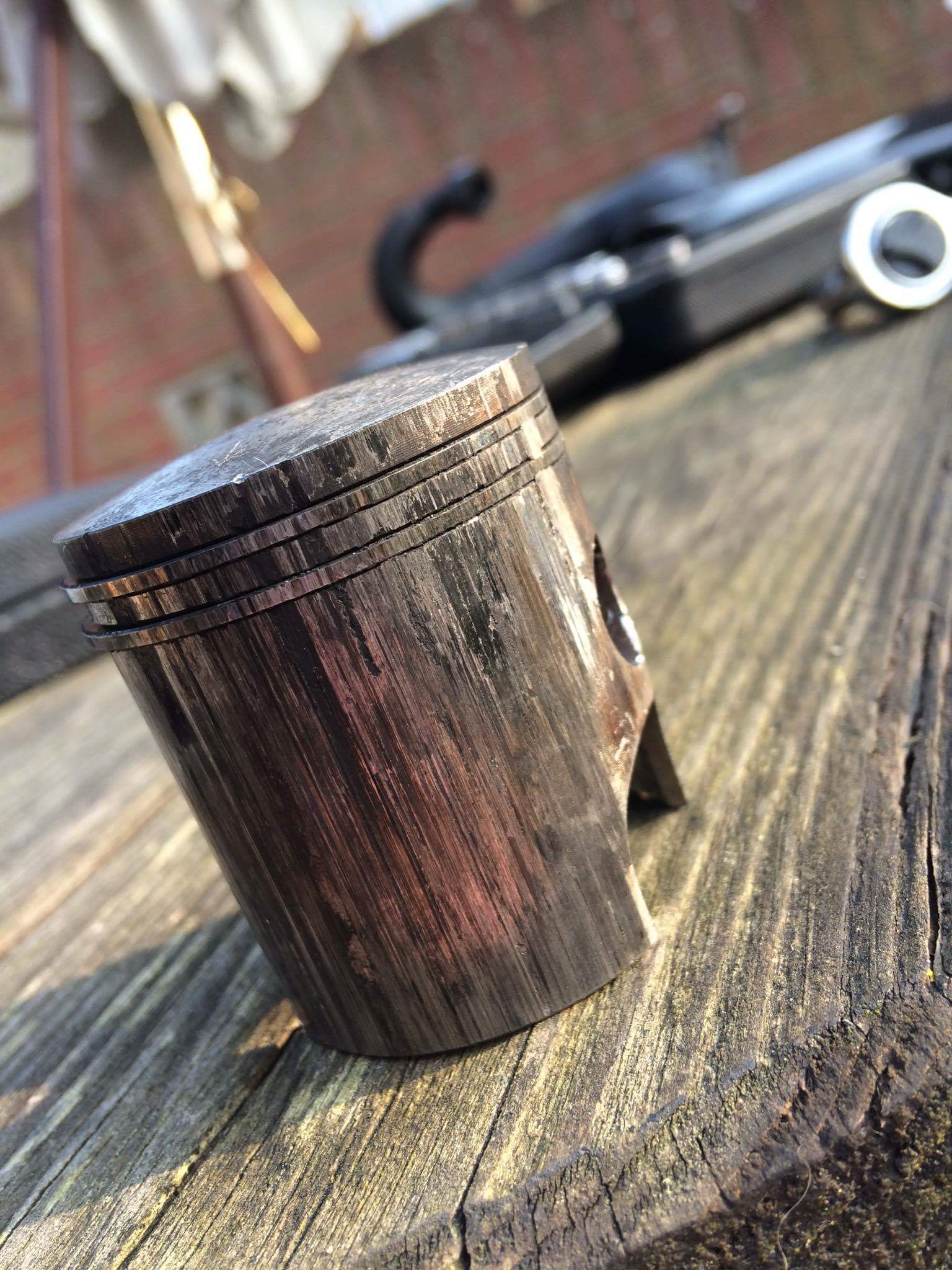

I have purchased a 1990 dt50mx and having upgraded to a larger carburettor, air filter and full performance exhaust. The previous owner had said that he put a 60cc bore kit in it 2000 miles ago. However whilst I was testing it, it was lagging power and felt like it was being held back. Not long after that it stopped and I presume siezed. But not fully as I could still push it and the piston could still come up and down.
I was woundering if I should put a 70cc big bore kit on it?
I was also wondering what I should do with the oil pump which mixes the fuel with the 2 stroke mix. Should I keep it or just mix oil in the tank when I fill it up? As this could have been a reason for the sieze?
Also could there have been any engine problems that would have caused this? The piston did not have a hole in it, but had loads of carbon and some small chips out of it.
I just need some advice and replies will be appreciated. I just want to get it back running.
Holy shit, that's a biggee,  , I take it you've    little compression now, , was there a  rattling noise as she seized ?,  it looks like lube starvation ,
.  member Wild foamy is an expert on these ,  hes done the big bore kits, .  I would add a temp sensor [ on plug]  and this could be saved before the bang,
You can't get a 70 kit for the MX, that's only the water pumpers. Google '4 corner seizure' as yours looks a likely candidate but we cannot see the rest of the piston, has it marked the barrel?

From the photo, a combination of a significant lack of lube and lean running.
A lean DT50MX will run, and it will probably do so for weeks on a normal town-based riding pattern, until you are on a long open-throttle run somewhere between Hungerford and Newbury (by the Crown pub) and then it grinds to a halt.

If an engine is running out of parameters it wont necessarily "seize" solid, my DT50 was hacking along quite happily and then faded out and died and would kick over all day, occasionally backfire but would not run due to the piston rings being destroyed as a result of lean running.i "seized" it twice and not once was it stuck solid, it would spin over but had no compression and would just fart occasionally.
