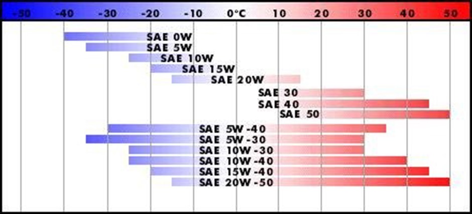

August 23, 20168 yr You must choose in weather specific scope. 80% percent of people says - 10w40 is better oil for V-Twin, but in my region in sunny days +30C and this oil too liquid for that engine. As a result, my transmission sounds like a bag of bones... terrible sound. Please, look at the temperature table and choose oil for your region.
