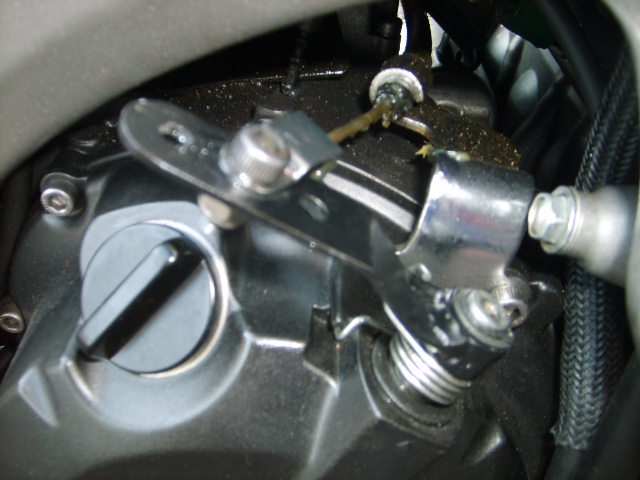

The piccys show the standard and the modded levers. Ive managed to get hold of a second hand clutch cover unit for a good price from a breaker, clutch cover, lever and cable supprt bracket, so that I can can mod that and try it. If I cock it up, I can still revert back to original with no hassle

There is one issue with extending the length of the slave lever.
If the lever is twice as long then the force needed will be half as much which is great, down side is the actual cable needs to travel twice as far to do the same work, so if you pull the lever over 1 inch normally the same movement will need 2. This may not help if you have early carpel tunnel.

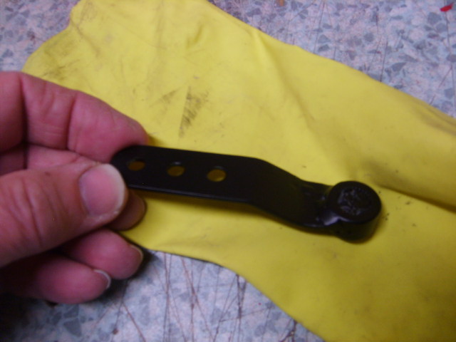

Finally got around to making the extended lever, nice little job. Not fitting it just yet though.

Lever looks the part.

Finally had some "me time" earlier this evening and fitted the home made extended lever
What a difference. I only moved it to the middle of the three holes to start with, and I couldnt be more pleased. Clutch is now as light as a feather, changes actually feel smother.
Ill keep a close eye on it, just to make sure its not creating a problem elsewhere on the linkage
if you can do something to remove the angle of the cable is a good idea to do it, at this angle your cable may be damaged in time... I think
Hmm, las has a point, looking at the earlier shots it does look like the bracket holding the cable outer is also a modified item.
Maybe there were some wear issues. Maybe something to look at esp as it works.
Yes, I need to obtain a spare guide now, and mod that to suit, dont like to risk cocking something up without a spare avilable. Oddly, it looks more misaligned on the photo than it really is. In the meantime, the cable is well lubed and will be checked every ride for fraying
