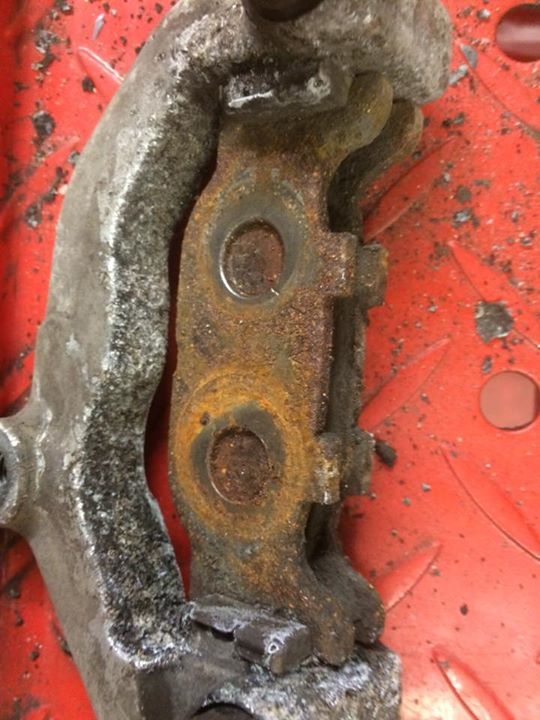

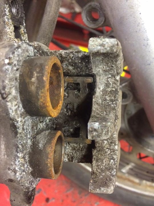

I got my bike 2 months ago and its been given me jip for a wee while, so I got someone to take my bike apart and he's noticed my brakes are rotten n fucked and my chain is far too loose. I'm considering going to the garage that sold me the bike because they appaz done a full and service check of the bike before I bought it, so I was wondering if this much damage could be done in such a short space of time. Just thought id check before raising hell and making a clown of myself.

Having said that, that looks pretty bad and probably like it for a while
You need to check what warranty came with the bike when you bought it. I can anticipate that the seller will say its out of warranty, and the rust and corrosion is as a result of winter riding/lack of care from the present owner
Having said that, youve nowt to lose
That caliper may need replacing, also the pistons and pads
You say the chains loose?, could be stretched, using the condition of the caliper as an indicator, id say the bike has been neglected. Likely to need a real good going over for other potential problems

I became expert at stripping and cleaning the brakes, not disturbing and lines just undo the caliper. Then brush and soapy water to wash the caliper and push the pistons out and back so they were free. Same with the rear, lost 2 rear calipers before keeping the monthly ritual. Scottoiler, cannot stress this one enough as well as getting a good quality stainless steel exhaust, (good excuse for an upgrade). Lastly have the garden hose ready to go, mine was rigged in the garage so it didn't freeze too much. If the hose is too much hassle to get/set up you wont use it. Just rinse the bike down after each ride. Don't get too excited with a cover as wet is fine, as is dry, without the cover the wind will dry it off quickly. Its the nasty middle ground of being left wet in a damp garage that does damage.

That rot on the caliper looks old decay to me, probably well estabished before you had the bike

Trouble is, it looks like you have some corrosion problems to deal with beforte you can get to that position
I've bought steel wool, permatex and afc50. I've been cleaning it every Saturday with muck off shit n spraying it with muck off protect spray but guess with the salt etc it just wasn't enough. I've also bought a better cover. For a first bike this thing has cost me a fortune.
