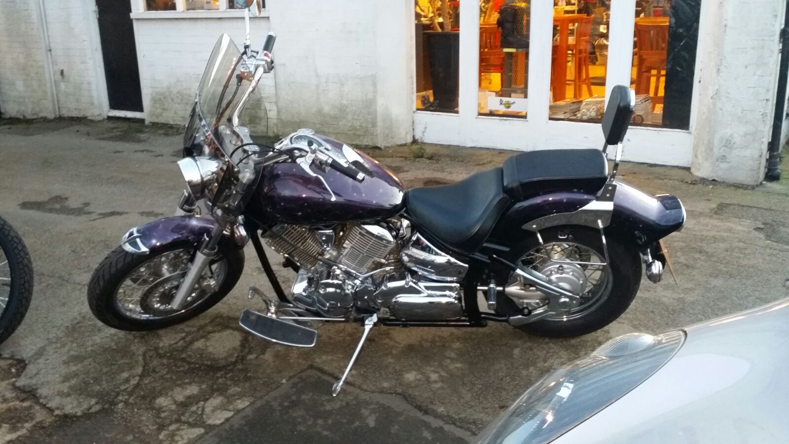

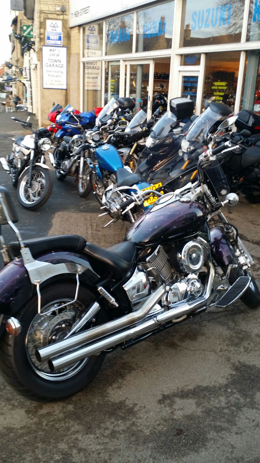

Hi everyone new member and bike ready to collect 2nd Jan.
buying from keep biking, Brackley Northants.
Test drove the 900 and 1100 having had a break from biking, my last bike was a Honda blackbird which kind of bought the worst out of me on the road.
wow what a test ride, comfy, loud with highway hawk pipes.
just s little hello and a couple of pics of my upcoming new toy.
Think some saddlebags are on my list, that and learning more about care of the bodywork / chrome as I don't want to be a fair weather rider.
Hi Phil, welcome to the YOC, very nice bike, all you need now is some sunshine.

Cool bike, not sure about the custom paint though. looks in good order.

Thanks for the replies really appreciate the advice and that it seems not quite such a labour of love to keep looking good
The custom paint lol
was just pleased to not have the basic factory colours might consider a work of art paint job in the not so distant future
