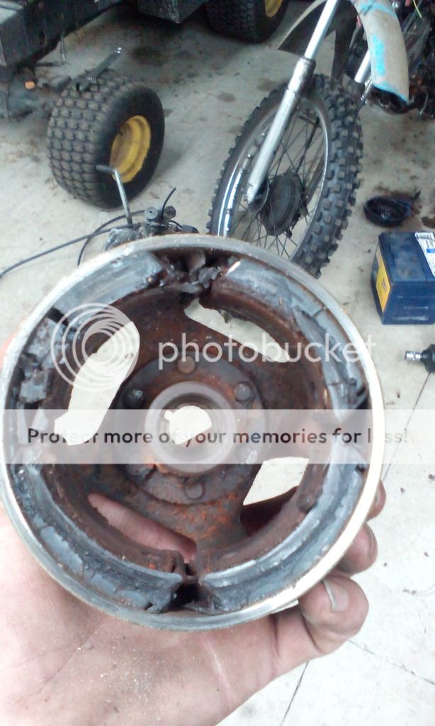

I thought I broke a piston skirt or a ring and it got stuck in the port or something, cause the engine locked up,   but I turned out one of the screws holding my stator plate on had come loose and was tumbling around in there,  unfortunately it smashed two of my flywheel magnets
it was a mk2 flywheel with the four slots I had put on a "78" motor  cause I blew a coil on the old stator ,    any way I got another coil off a friend of mine and will have to put that back in there  so I will be running the stator with the low and high speed coils wich requires the 7 wire cdi wich got damaged when the high speed coil blew

well were going again guys,       here is a pick of the magneto I smashed the magnets in,   just had to be bad luck to do this amount of damage  people spin there stators all the time and never had or seen this         any way had to mix and match some parts,  little bit of stuffing around but all worth it in the end ...        any way spent the last hour making this ........ hope this  helps others  fix or understand more about there ignition timing  aswell  IMG_20151222_115930_1_zps2vb0mla3.jpg
(stator screw fell out and  jammed in the coil gap shatterd two magnets)

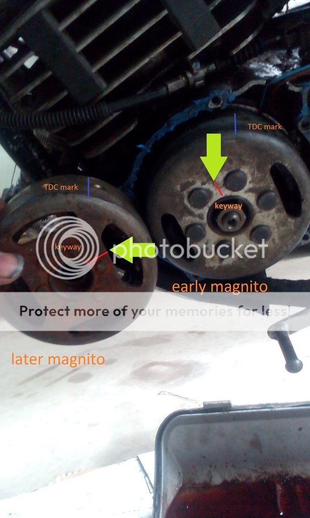

  late model 6 wire stator will run on the early magneto with no probs at all very nicely,
  but new slot locations need to be drilled in the stator to find tdc,

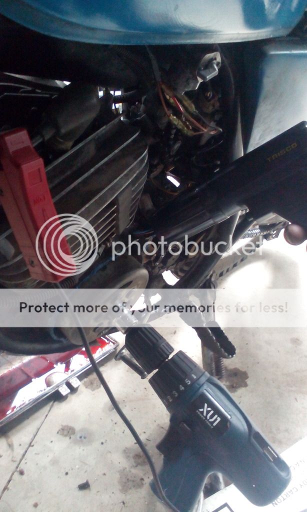

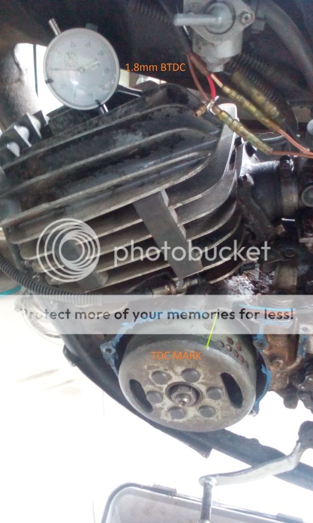

firstly.... I used a dial indicator and measured the piston at 1.8mm BTDC,   because im using the original flywheel the  marks line up with the casing    pull the spark plug out connect it back to the lead and rest it inbetween the fins on the head this should ground the plug IMG_20151228_164033_zps32sbtg30.jpg
secondly..    get your timing light out,   you will have to run it off a separate power source like a spare 12v batt,      put a 19mm on the flywheel nut  connect it to a cordless drill and spin the engine counter clockwise
  (you will need atlest 200rpm to create a decent spark to fire the timing light) IMG_20151228_143003_zps1hmt4pnw.jpg
  when it does flash you need to find your     flywheel TDC mark   (wich could be anywhere in most cases)  ,  mark the casing in relation to where TDC on the flywheel is showing under the timing light  flashearly%20late%20mag%20text_zpsfurcg2vz.jp (the diference in alingnment between the two mags notice the diference in the keyways between the two )

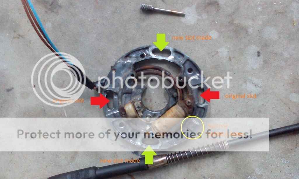

 thirdly.... once that is done and your new timing mark is there, set the original timing marks back to factory and mesure the distance from you factory TDC mark to the one you made just before  with the strobe light,
       this will tell you how far your stator is out  and has to be adjusted!   , it pointed me to where some factory scribed holes were located  (they obviously used the same plate on lots of diferent models and drilled them accordingly)    "as did I"       when I rechecked the timing it was dead on ;)
 i  dident need to but............... I like to a have a  little bit of adjustment....  so I sloted em     gugbj_zpsffqvyhmy.jpg
