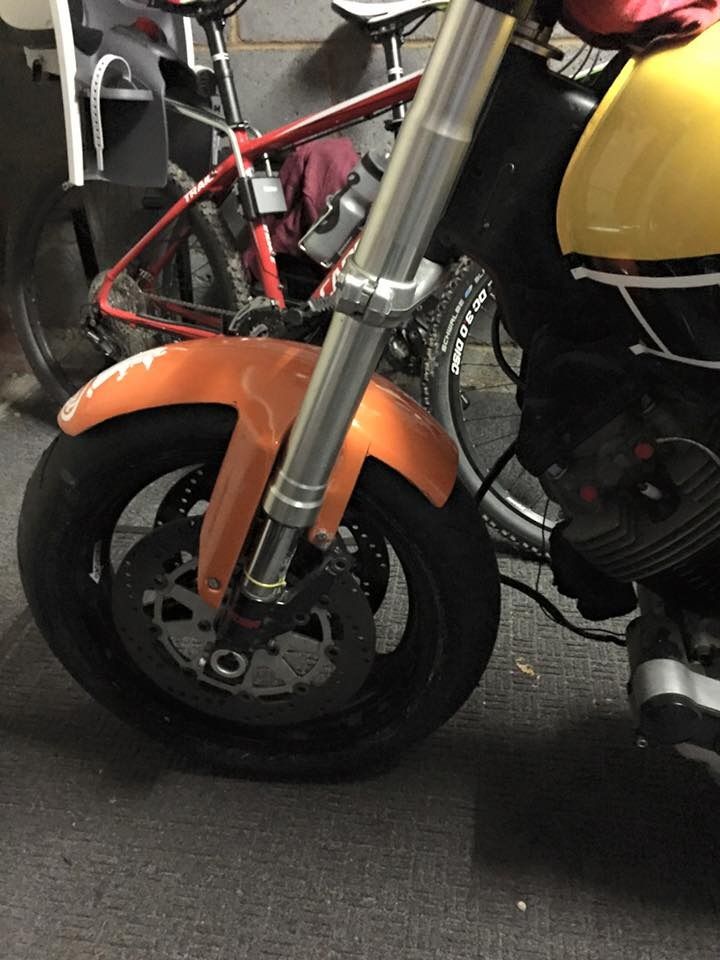

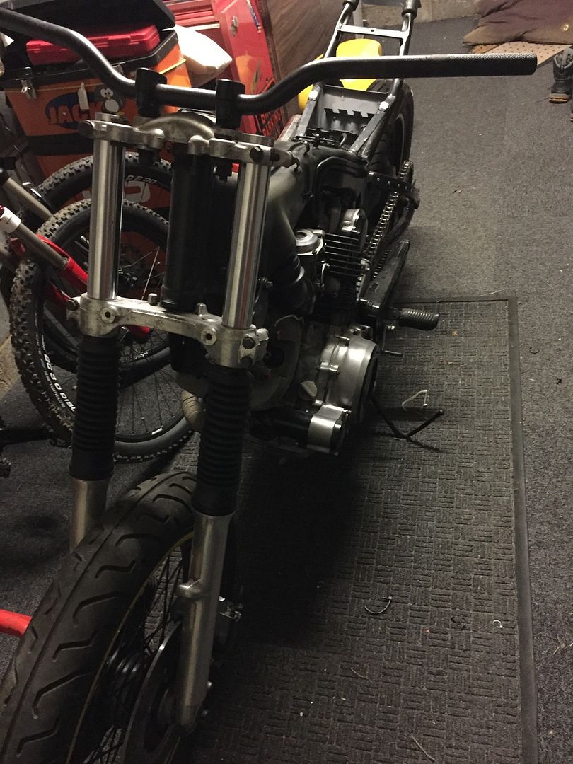

So, got myself an '83 TR1 that i wanted to bring up to date and turn into a bit of a street tracker look
First job was to offer up the new front end I will be using - a 2004 GSXR750. Replacement bearings is all that will be needed (apart from maybe reducing the height of the head locking nuts)

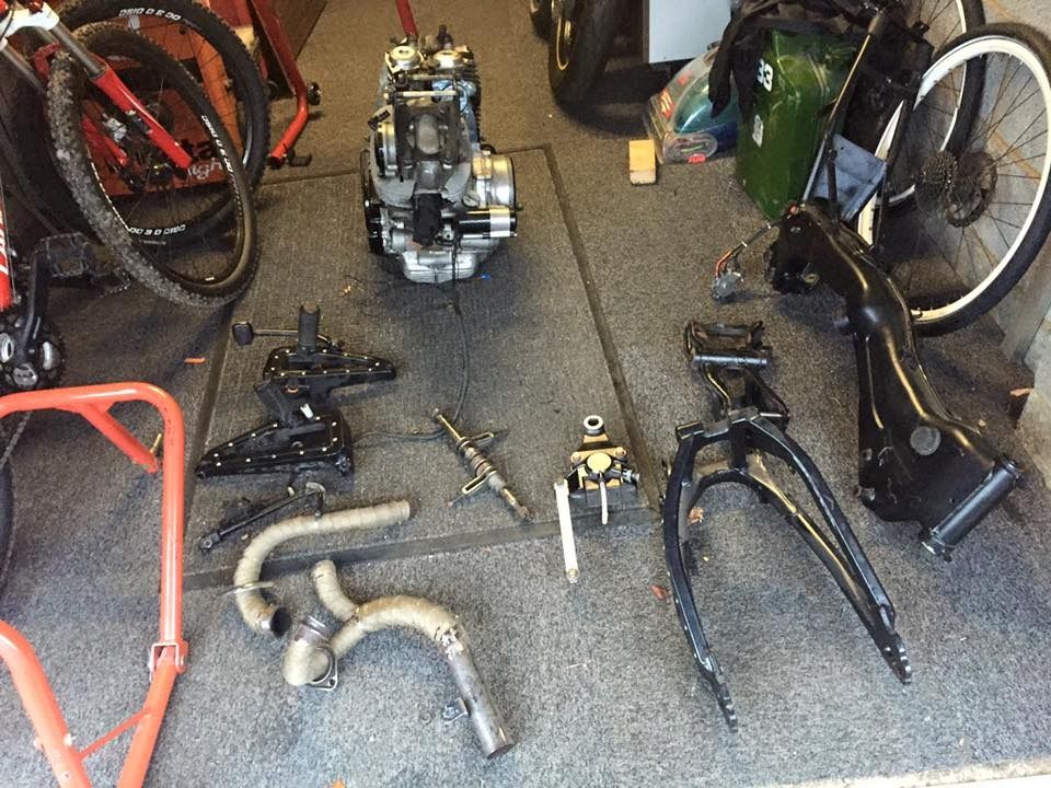

Then the strip down started. Electrics aside, which were a mess, there were no hidden nightmares

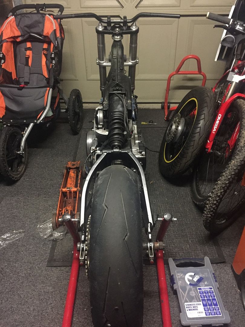

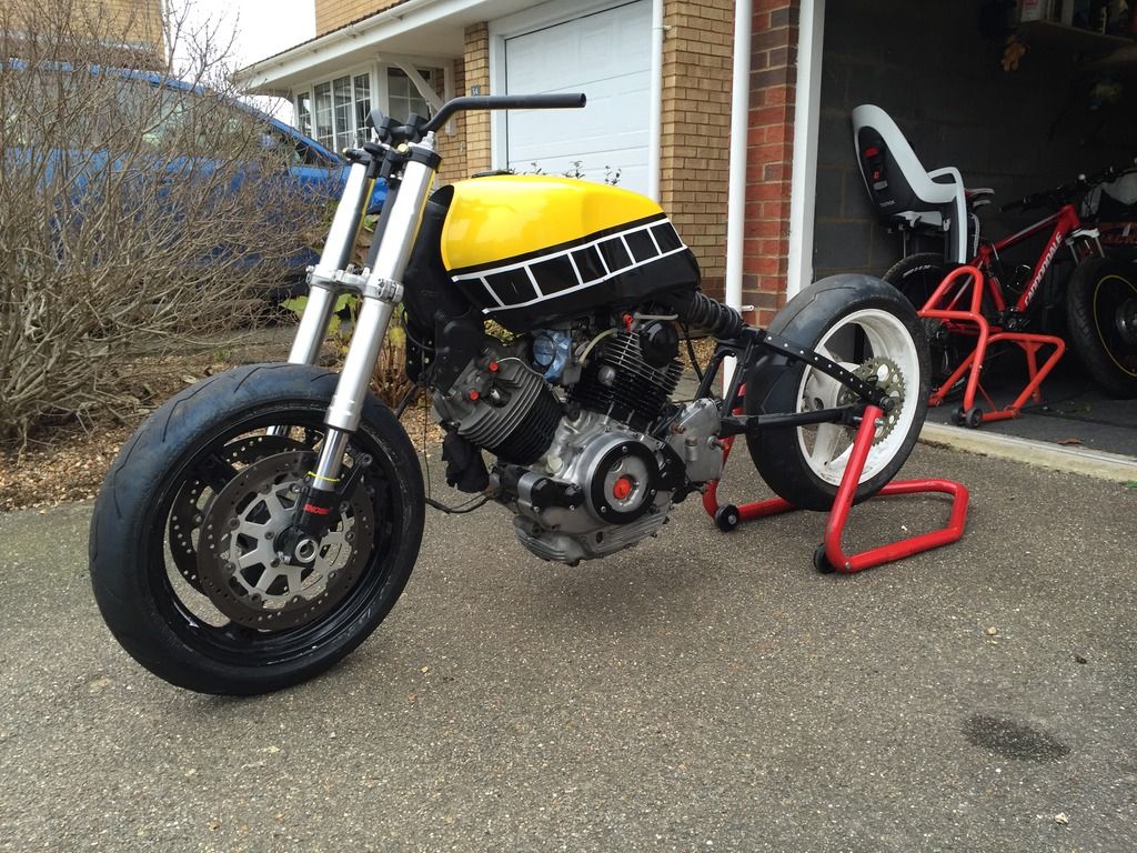

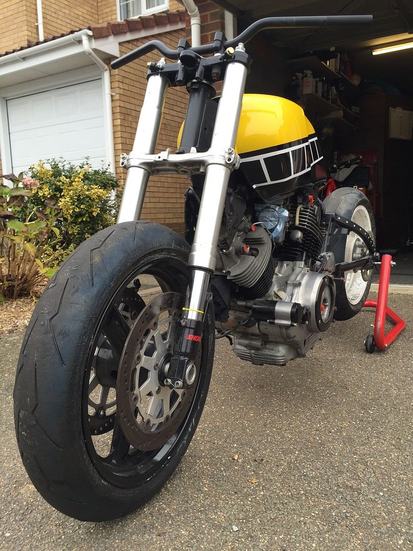

  • Quickly chucked the thing back together (there will be a lot if stripping down and building back up) to have a look at the effect of the frame cut. I'm more than happy
  • Another bit of mesh to tie things up a little (probably have a small bit on the rear hugger if and when I acquire one). Mesh and mudguard will both be black &#13

hey Jack, that front end looks the dogs, you gong with wires all round or the mag wheels?
lots of bits can be got from redmax speed shop, not cheap but there's only USA/ebay after that.
yes, old sucks. Just have to get on with it mate
GSXR750 front wheel with SV650 rear (I race Minitwins so have plenty of SV wheels about lol). Would love to keep the wire but alas these ones are 18" so can't get good rubber for them.
Once the build is complete I'll start looking around for spoked wheels but I don't want to hold the build up by waiting
This is more for the road though and I have access to plenty of Supercorsa scrubs ;)

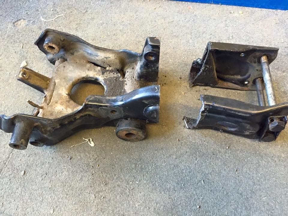

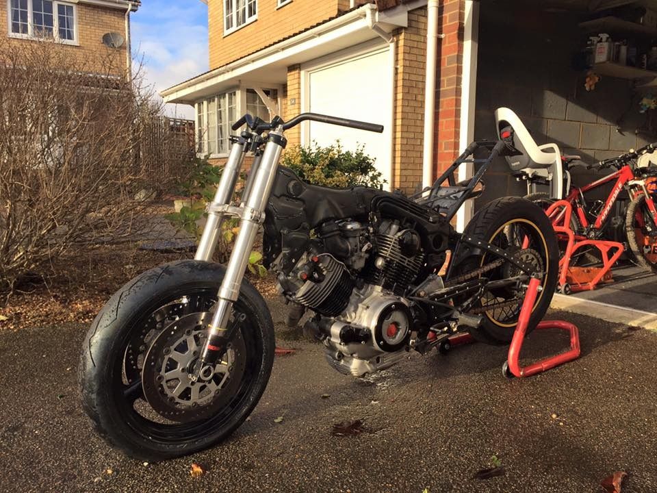

Well the chassis cutting has started
Edited by Jack R1
1 lump or 2?
Out of the 5 items in the two cut down pics I'm keeping two. Lets play a game lol

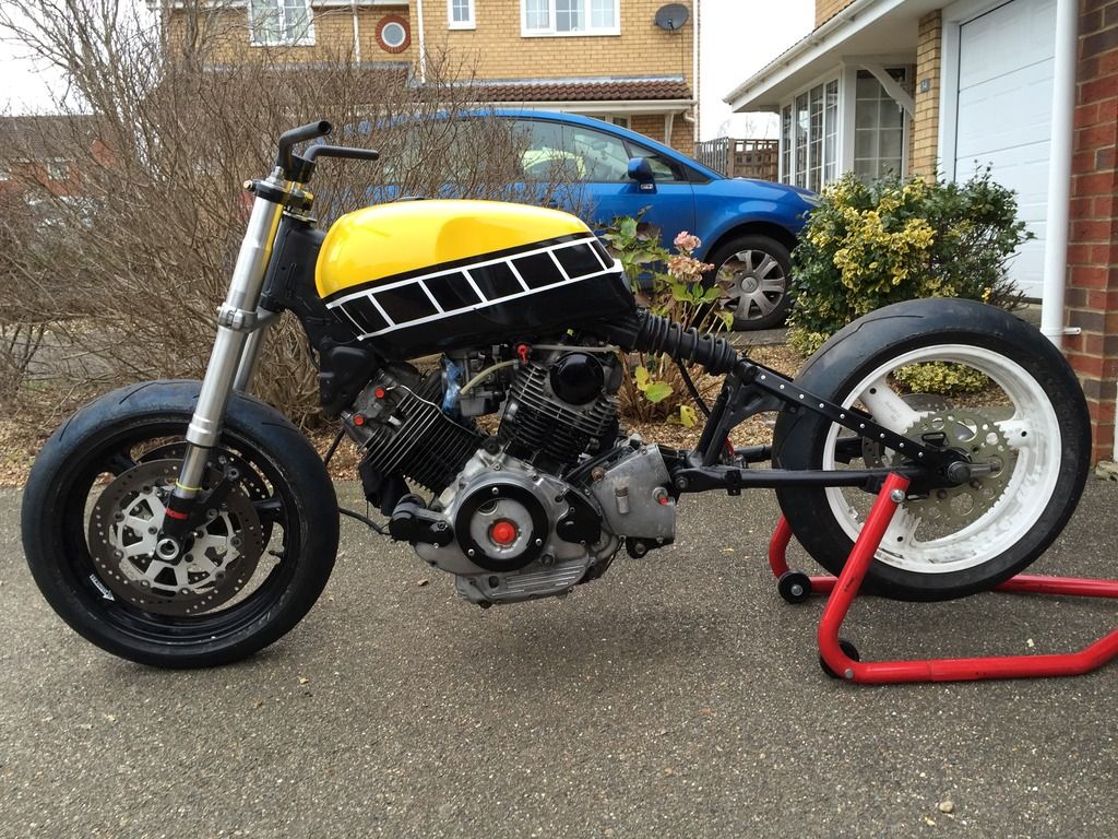

good work sir.. a bike i always fancied owning ..keep at it:D
Well the 160 rear tyre on an SV650 wheel seems to fit. Just need to make some spacers, get a slightly shorter spindle and / or machine a little of the sprocket carrier for alignment

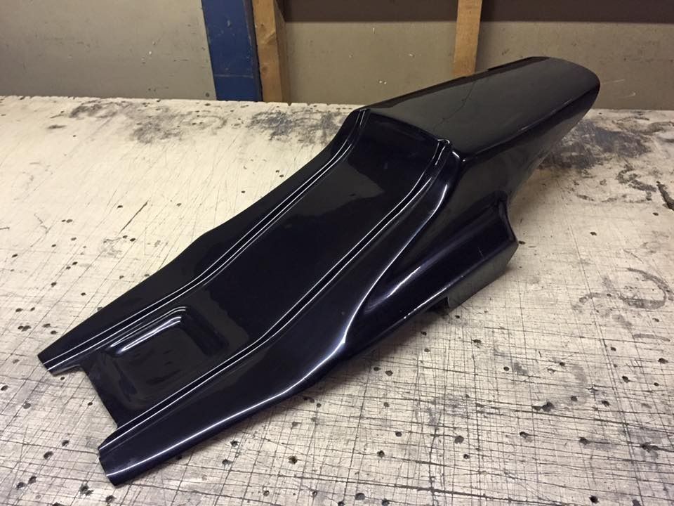

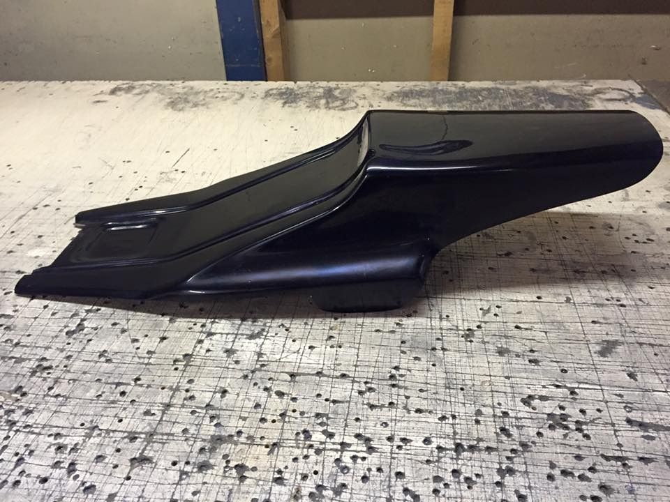

Gutted the seat unit didn't turn up before the weekend (hernia op on Tuesday puts pay to any work for a little while) but pleased with the general line on it

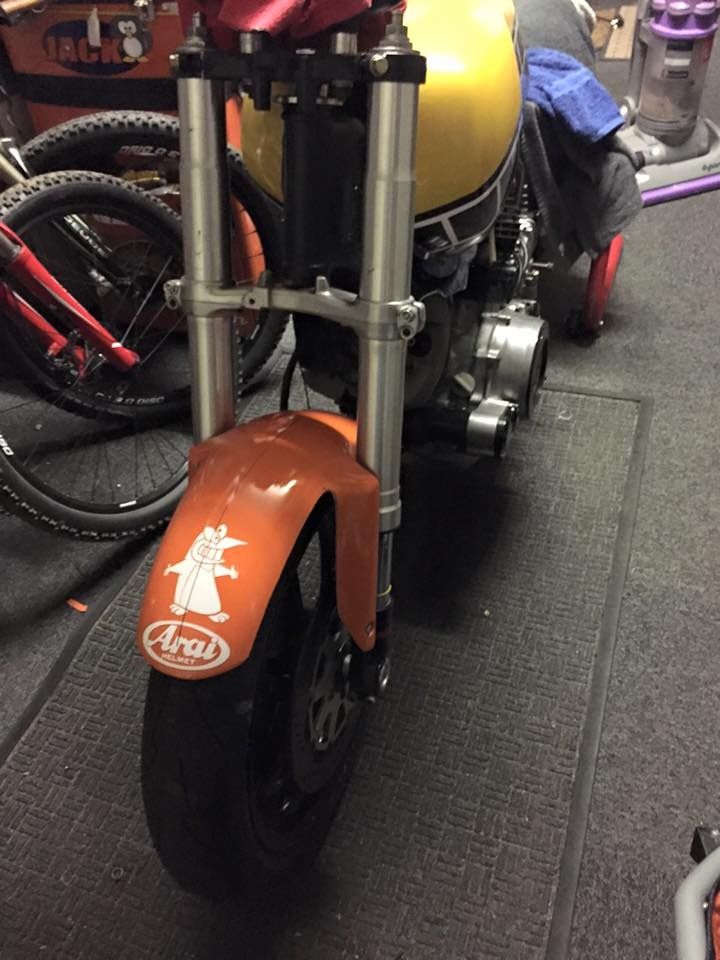

A wet, windy and miserable Sunday meant I had some things to do around the house. Only really had time to start playing around with the front mudguard (it will be black btw). I think I need to shorten the front and completely semi circle the front and rear. Any thoughts ?

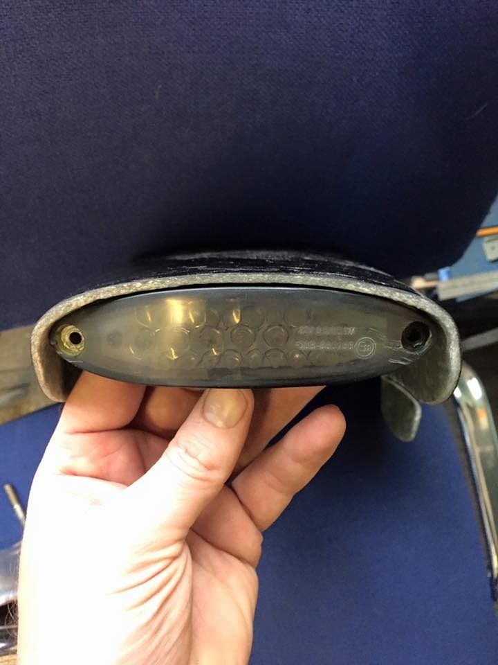

I'm getting quite lucky with some of this. The rear light I had (and was hoping to use) fits the seat unit nearly perfectly

love the colour of that tank, proper yamaha. the front guard as you said id shorten the front and round of the rear of it... keep at this thing is gona look proper good:D
