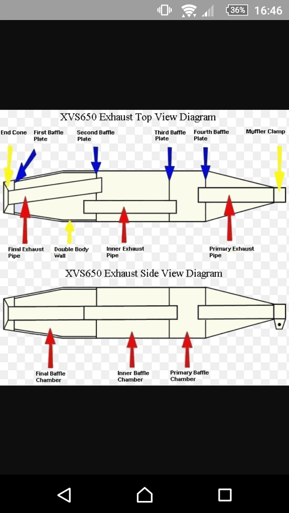

This is what's in the stock pipes.
Unless your good with a welder it's quite hard to gut themfully. Best to save up n get a set of vance and hinds.
Screenshot_2015-11-07-16-46-48_zpsxsu35z
I agree, i've been down that road and to be honest they sounded a bit "wet farty" when I throttled off, so bought some Vance and Hines.
