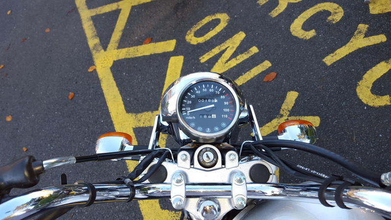

replaced the clock with an after market one.
Looks sweet as hell! Will post a picture when I can.
Cheers for the advice!
Nice, did you need to configure it at all (ratio? as you mentioned - useful to know if it does come up again) Does it plug straight into speedo cable? Would be good to see pictures.
Speedo cable fit right in. Got someone to follow me in a car. I raised my hand when I got to what I thought was 30, then 40 and then 60. 30 Was on the dot, 40 was real close and 60 was actually about 53. I have not done any additional config as I have no idea how, but I am not entirely fussed as at least I won't be caught speeding. If I remember, I will post photos tomorrow. :)
