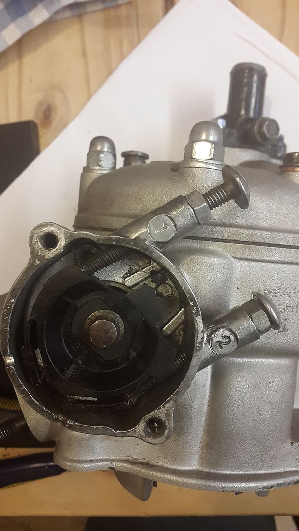

You can pin the power valve open till you get a new servo will loose a little bottom end power but will have full power up top end
Thanks Chalkey for pic, I put power direct to servo motor from Battery and nothing happened so thinking that motor is duff, i may have to pin it as per pic till I get new unit, i take it the slot and hole line up for full power position.
yes that's right, what shape is the end of the pv though, either diamond or rectangular with two curved sides?
Rectangular with 2 curved sides Airhead.
right well like you said thennIt will be fully open with the U of the pulley and the blind hole in alignment...unless of course it is 180 degrees out of position, in which case it will run rough!  If it goes like stink it will be right, if it doesn't you better take off the exhaust and make sure the top of the port has a smooth flat surface all the way through the pv to the bore of the cylinder
They are supposed to yes but I would remove the expansion chamber and put a finger in the exhaust port to make sure the power valve is in the right position ie smooth to the port as some times they can be 180° out
Well pinned it open and boy does she rev now when riding 9000 rpm plus, but had to laugh as it is all hills here so she really struggled up the hills so going to adjust pinning position, have ordered a 2nd hand servo motor off Ebay so all should be good can definetly see why you need adjustble servo for better overall performance.
