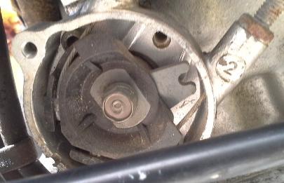

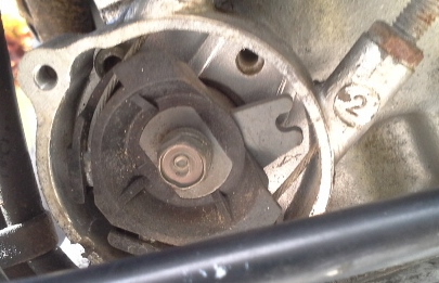

Well took cover off power Valve and turned key on ignition  nothing happened revved bike upto 9000 rpm and still no movement this is how it looked whole time ,so I guess this is not correct lol, so how do i get to the pinned articles so I can carry on in my quest for world domination on my DT 125 R, bloody hell this coffee is strong, cheers.

Go to workshop ",section,   pinned threads are have a  green PIN, beside them ,   your p/valve needs cleaning,

when you turn on the ignition key the pv should do a couple of cleaning sweeps, you should hear the servo motor noise 'zzzt zzzt' as it does this...then after the cleaning that U shaped cutout should be in perfect alignment with the blind hole you can see at the top.
you should investigate whether the pv has become seized in its current position maybe...is the pv servo electrics plugged in?

Took plastic section off and metal key ? turned easily so refitted plastic pulley and bolt, will investigate further tomorrow thanks for advice will let you know how it goes tomorrow ,going to look at those pinned threads,cheers again.

Well all wires connected up to powervalve checked fuses OK ,pulley wires connected but nothing happening when turning Key, any clues anyone I hate electrical problems ( growling noise ).
Hmmm servo might be duff then. If someone's had the PV pinned open at some point it may have damaged the servo
Hi  Yes power valve turns when plastic pulley is removed very easily actually, took tank off and checked connections at servo took cover off it to expose pulley wires ( not to tight )  but pulley will not rotate at servo but I think this is because it is electrically driven so could not be manualy opened, so I am thinking the servo is Kaput, bike  can be ridden just needs revving alot.
WOW 336 GBP for a servo for that i want it transforming into a RD500LC  LOL , think i have found one on Ebay for 85 pounds second hand, seeing as i have in my short time of owning bike never had a operating servo do they make a differance to the ride quality on bike if not operational ?
