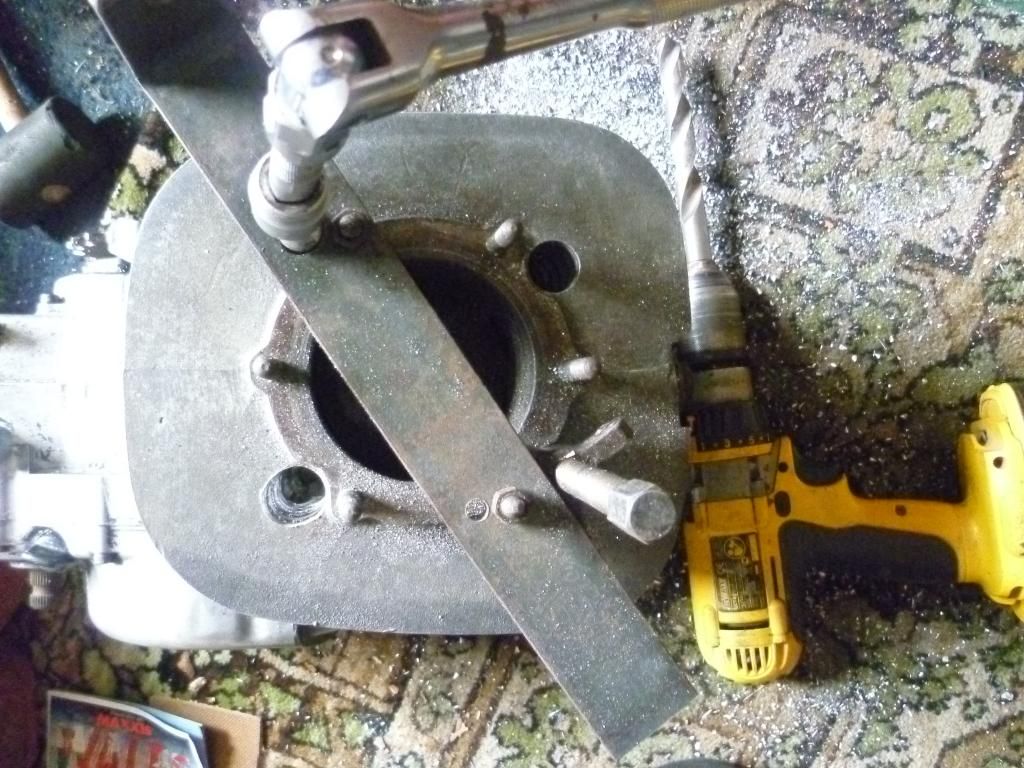

For the love of god, has anyone got any ideas how i can release my barrel from my truly rust engine please?
I made a puller that attaches onto the rocker cover bolts then tapped an 8mm bolt so  it coudl be wound down to press on the piston to "pop" the barrel off.
I thought it sounded good in principle, all i managed to achieve was a 8mm hole in the piston :( I then tried to reinforce the piston with the only thing i had to hand - a 50p coin, retried an ended up with a 50p with a 8mm hole through the middle
any thoughts??
Soak the barrel in diesel over night to loosen the piston, then heat the barrel. Should work but you might have to do it a few times. Steel plate over the top of the piston, your local engineers should have some plate knocking about, get them to cut you a lump to fit inside the hole.

Heres mine,  bolt plate to the barrel studs, and push down onto the  casing studs,

I made a puller/ pusher, like yours attached to the barrel studs, but stupidly i was trying to push off the piston - rookie mistake i know, but didn't know what else to push/ pull off with it all being ally

possible thoughts now are, seeing as the piston is now goosed, if I try an remove as mush as the piston as i can avoiding the barrel at all costs, could this relieve the strain?
Yeah that would work, hammer out the middle and knock as much away as you can. Tho not sure what that would actually achieve as all you would have is a stuck piston with a big hole in it? Getting it out of gear or disconnected from the gear box would give you some ability to move the piston which you can't at the moment if it's stuck in gear, you could then hammer the piston down the barrel with nothing else connected. Just a thought.
if the piston is stuck with the crank, cutting away the small end will let you take the barrel off.
 If both are stuck, then you would have halved the effort removing the barrel taking the piston out of the equation.
