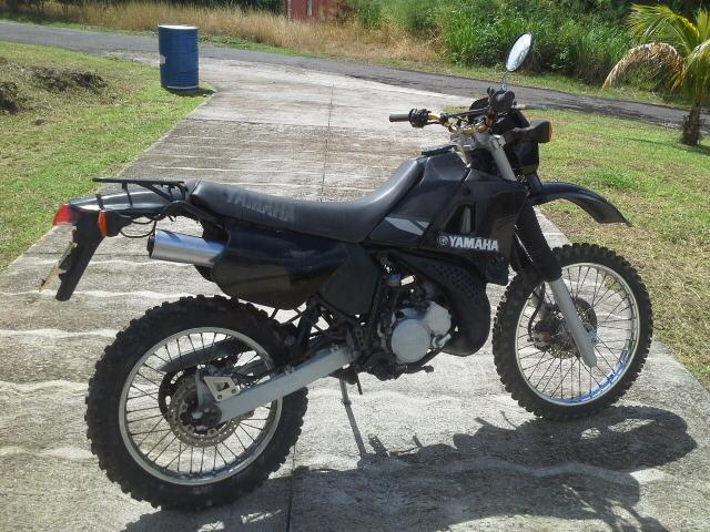

Attached is pic of Bike you will notice it has a Kawasaki KH 125 tail pipe bike came with it.
