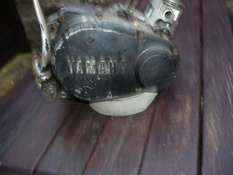

here is a pic from what i was sent
it looks to be in a damn site better condition than mine...
If its REALLY cheap. Gutter bolts in the sidecase and a welded on gear lever.
Whats so wrong with yours that this looks like anything other than trouble.
Need a picture of the other side to be certain its not an early lc bottom end.

its only £50, even if i can just use the left hand case, generator etc, its in better condition than mine - which isnt hard
im hoping out of 2 rotten apples i can make one good..?

Replacement/ donor engine has arrived an looks a million percent better than mine.
Think i will just swap the case over with the number (so they all match), It even still has its oil pump installed  :D
