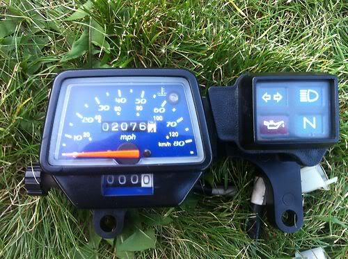

Hi all has anyone tried to repair this type of speedo? the cable seems fine the drive is working. The needle is not moving and the milage is not moving,
any ideas would be gratefully received
cheers

hi paul
i have taken the cable off the back of the speedo and spun the front wheel and the speedo end of the cable turns. i will have another look maybe the cable end in not locating properly in the speedo.

On my FJ the actual spring inside had broken, that meant that the needle didn't move but the mileage counter worked, does your counter work? cos if it does then it's your needle return spring that's broke. You can't fix that I'm afraid it's a new or replacement clock.
hi slice
no nothing is working the mileage is not moving.

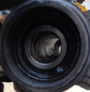

Hi all i need some advice!!!
I have discovered the cause of my speedo being intermittent. On the DT125X there is a single lug on the hub to drive the speedo gear and guess what mine is missing. i have been getting some movement due to the speedo drive gear rubbing against the hub as the tabs on the drive gear look a little worn.
first pic is my hub no lug

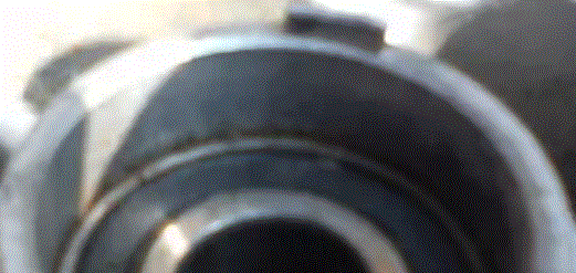

second pic is how it should be
my question is do you think it would be possable to drill the hub and insert a pin. the pin would only be driving the speedo gear so should not be under a lot of strain.

That's a bit of a bugger isn't it? As Kev says your best bet is a new wheel I'm afraid, drilling that close to the edge of the rim is going to be a nightmare, you could weld an ally tab onto it but not sure how long that would last. Do you know anyone that does ally welding? You could get them to do a build up of weld and then file and grind it back to size but will be a hell of a good welder to get it just right, can't you find a cheap second hand wheel?

Well i got back from a day at my parents earlier than i thought with an hour of daylight to spare so i whipped my front wheel off. i drilled the rim of the hub with a 1.9mm bit and knocked in a 2mm roll pin leaving in about 2mm proud and jobs a good'un. speedo works perfectly.
