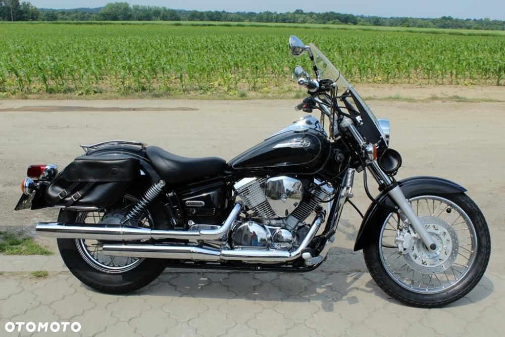

Posted September 6, 201510 yr I'm utterly delighted with my new Yamaha XVS 125 Drag Star. Visually, it fits my bill and I can ride it legally here in Poland until senility sets it. My Harley-owning neighbour couldn't believe it was a 125. What's not to like? Well, to my tastes, the front wheel's too large in diameter and too narrow in the rim. Looking at the 650 Drag Stars - there's the base version, with an 18" front wheel and a 110/90-18 tyre, and the Classic, which has same 16" wheels front and back and 130/90-16 tyre in the front. Now, my 125 Drag Star has a 130/90-15 tyre at the back, while in the front there's an 80/100-18 tyre. I read somewhere here that that's a big difference in widths between the two. Visually, it looks chopperish rather than cruiserish.What's stopping me (other than the mudguard) from fitting a 15" front wheel with a 130/90-15 tyre on it, so I'd have the same front and back, classic cruiser style? Or if that's too radical, how about a 110/90-15 up front? And whitewalls would look good too :-)Thanks for the feedback (anytime between now and the winter lay-up would be good!)

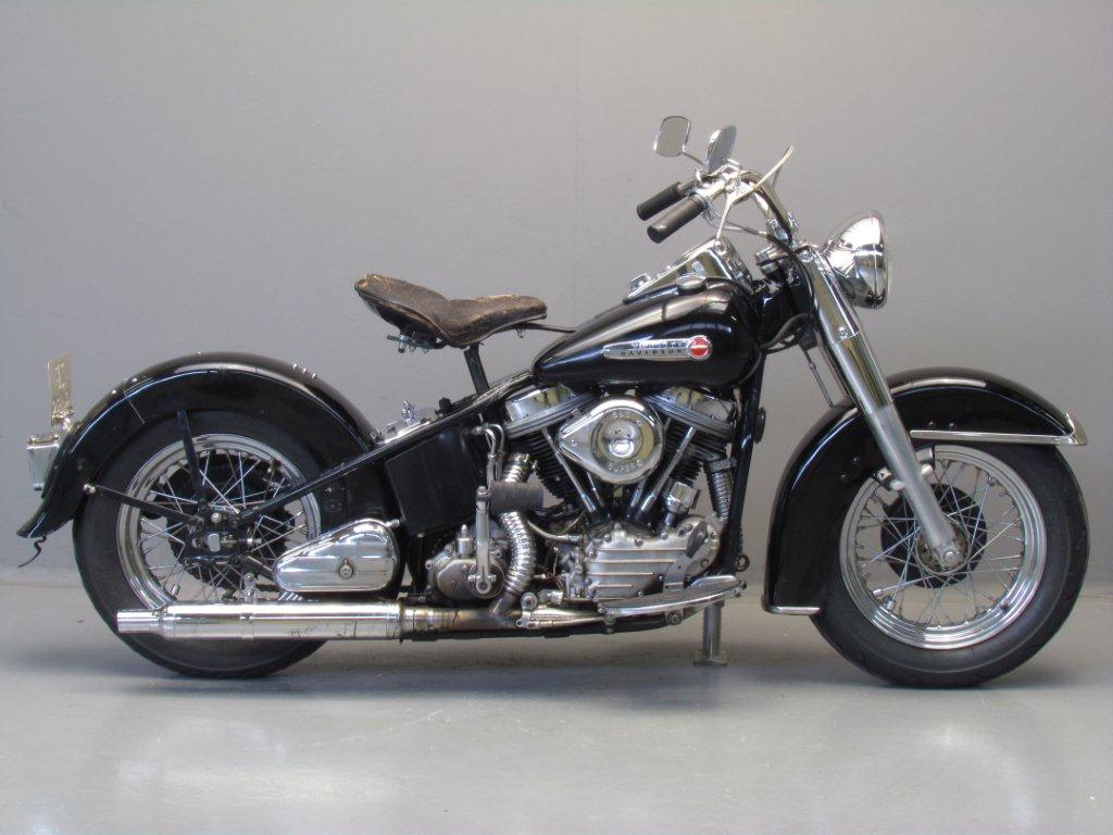

September 11, 201510 yr Author @ Ttaskmaster I'm more into 40s and 50s Harleys. Balloon tyres of equal size on equal rims front and back. I'd be going for a wider rim (to answer blackhat 250's point) with a wider, higher profile tyre on a smaller rim. And the right size mudguard to go with. I don't do leaning into corners; cruiser riding is about going slow in top gear, put-put-putting along. Stability from cross-winds is a more important factor. But above all, it's the visual thing - I want my Yamaha to be the nearest thing to a 1951 Harley Davidson Hydra Glide with a 125cc engine :-) Edited September 11, 201510 yr by 125's Enough!
September 12, 201510 yr Author The Sunbeam S7 was the first motorcycle I really, really liked visually. At the Science Museum in London in the 1960s. By the turbine-powered Rover Jet 1 and the Mini cut in half. Finished in mist green, with those balloon tyres, the S7 must have disappointed sportier riders - the S8 had narrower rims and regular tyres. But for me, the S7 is the nicer looking bike.

September 14, 201510 yr Author @ Ttaskmaster: "If you want a 1951 Harley Davidson Hydra Glide, it may well prove cheaper to just buy one rather than modding a 125 Draggie, except if that's an intentional project."Except I won't be allowed to ride it, given its engine capacity is over 125cc :-)Having fallen in love with this Dragstar, it will be a slow and careful job. Had a few anxious moments as I felt the narrow front wheel lose grip with assorted strips of anomalous material in the road - shiny tar, metal grids, damp gutters. Not sure an 80-width front tyre does the trick for me. Would feel more confident with a greater area of rubber in contact with the ground up-front.My Derbi CrossCity 125 has a 100-width front tyre - it feels surer.I'm starting to toy with the idea of buying a second 125 Dragstar to make over into something totally custom, solo, mini Hydra Glide replica, keeping this one for touring. :-)
