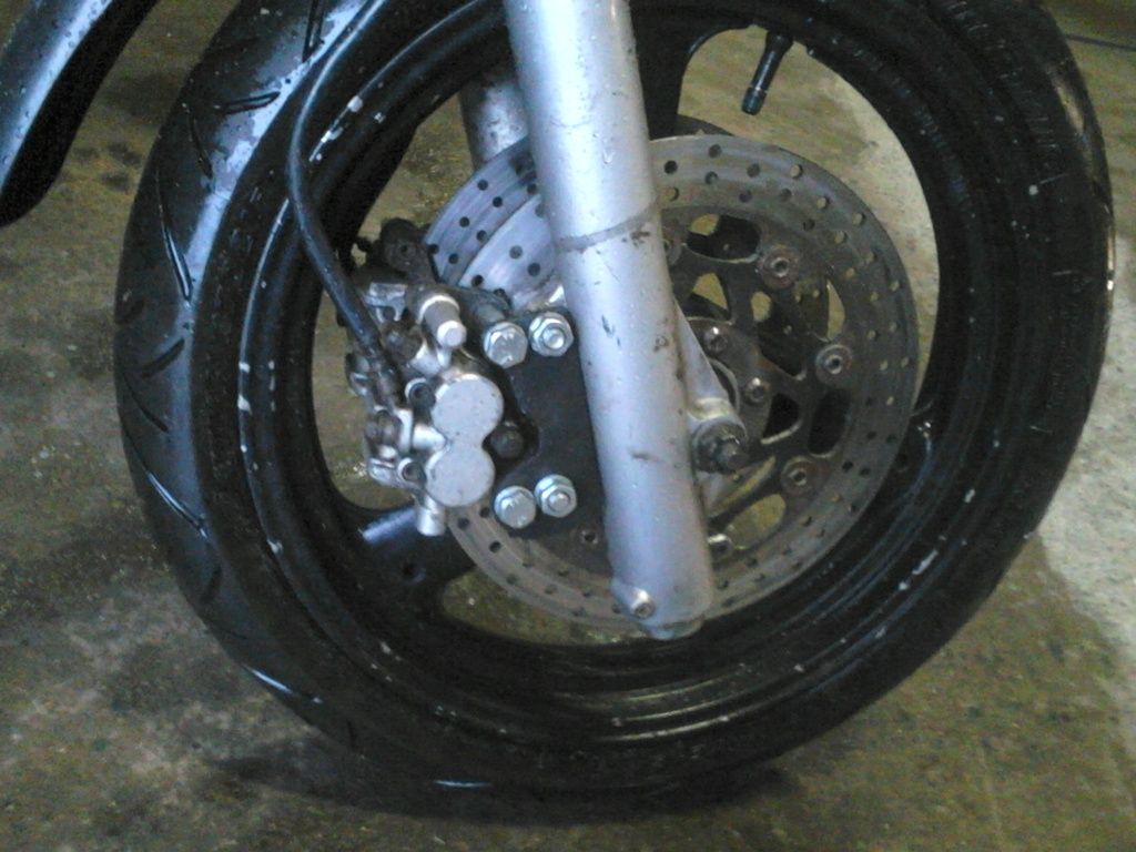

Har har , Ah no , I won't piss on his parade . Why spoil the fun . I thought those Rotax V-Twins were supposed to be pretty solid as long as you keep up with the oil level/ changes .  The lad seems to have picked up a bit of knowhow on this  "build?" , lol , not sure if that's what to call the dogs dinner,so he'll be able to work on it himself  .  Anyway , got the front wheel on , fairly handily too .  We had to turn the discs back to front , or was it inside out ?  I forget , but instead of being dished outward they're dished in instead .  A 20mm wheelspacer on each side fitted perfectly .
As the discs are much bigger than original we had to make up plates to space the brakes  out . These were made up out of 4mm plate (after making a template from a thick piece of plastic), machined to very close tolerances with the big angle grinder and lovingly finished with the bastard file . The lad played a blinder on those , fair dues .  Off to the local engineering shop for stainless bolts and spacers , a tenner the lot , fitted a treat and well secure . The rear brake had to be shimmed in 10mm and that was sorted too , just have to rebuild the brake and pop it on .
The wheels are now 17in front and an 18in rear as opposed to 21in front and 17in rear so the steering will be very different to what it was before . The front wheel also looks very wide compared to the rear , though maybe tyre choice could help on that score ?  I hope it handles ok because if it does it's a fairly solid bike now and, although no different cosmetically , it looks pretty purposeful .   I was going to say it looks a bit like a TDR250 or the early TDM , but that would be going a bit too far , lol !

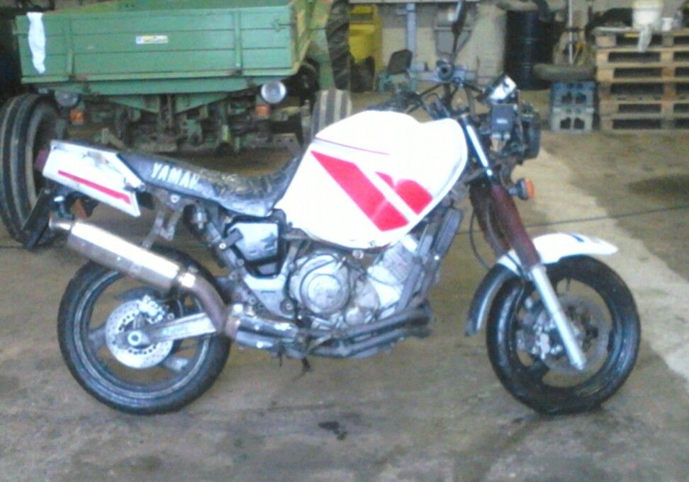

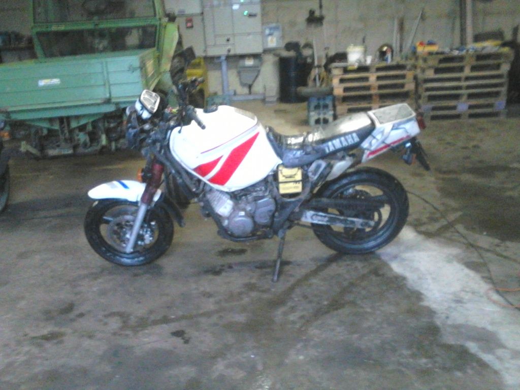

BEHOLD ! In all her filthy awesomeness!
Doesn't actually look too bad (from a distance , lol) , even if I do say so myself !! I've built it , but I'm not feckin' cleaning it !!
Well I have to admit that it does look like something out of a bad movie but your never going to have to worry about dropping it are you? :lol:
A VERY bad movie . Every cloud has a silver lining Slice , lol .  Goes like shit off a shovel though !! And those brakes'll put ripples on the tarmac . (She was never a looker to start with ).
