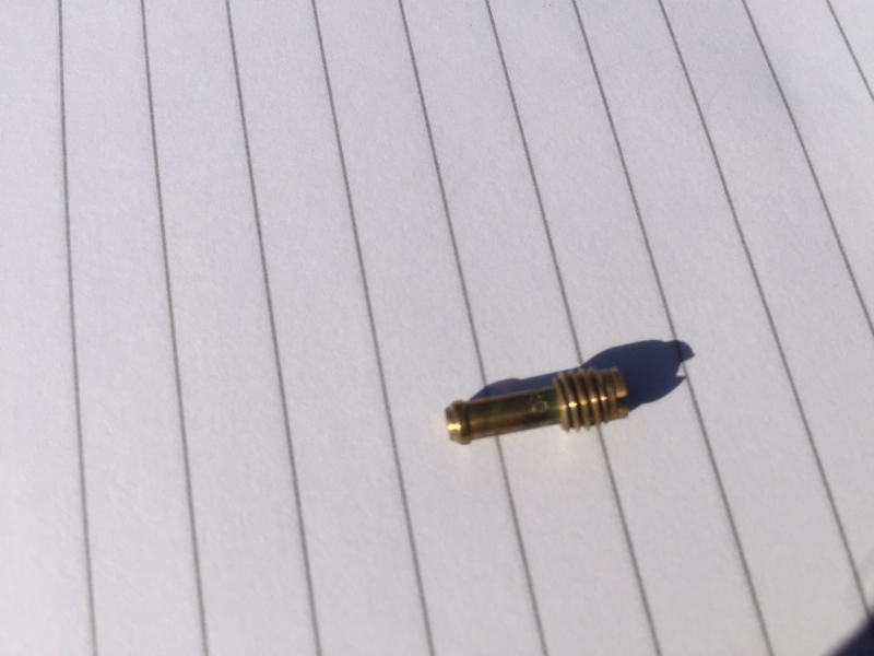

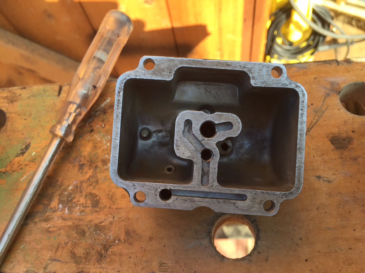

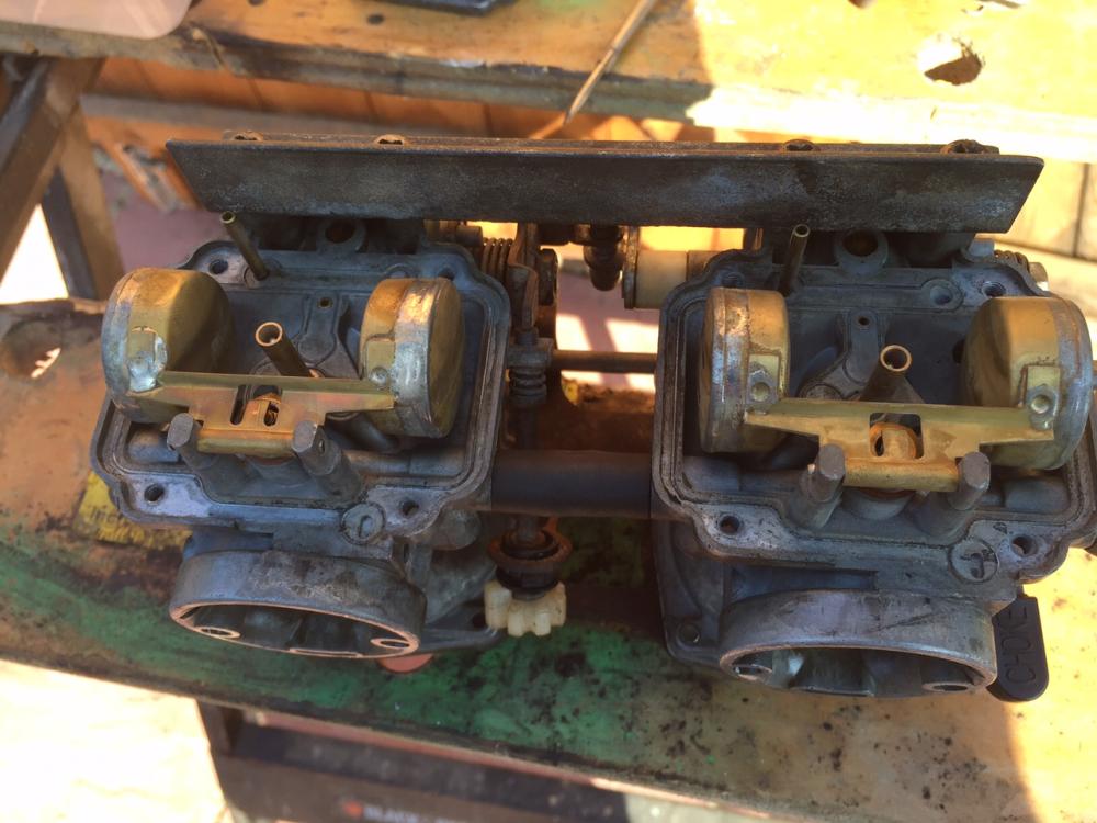

August 8, 20159 yr Author Hi got the carbs off and apart. They seem clean and I have taken out the jet I think you mentioned. They are both E120 and I will give them a clean and blast out. I have posted some pictures.
August 8, 20159 yr Author Checked to inlet rubbers and they are both fine, the od of the carb outlet is 31.5mm.
August 8, 20159 yr Moderator on the float bowl, see the little drilling on the lip? shoot some carb cleaner down it, thats the choke route.
August 8, 20159 yr Author Done that and put it back together started straight up on the button. Turned it off and would not restart then battery died. Jumped it off car started ok a couple of times. Took jump leads off and wouldn't start used the kick start and it went. The electrics were supposed to be done but do you think it may be a voltage issue after all that
