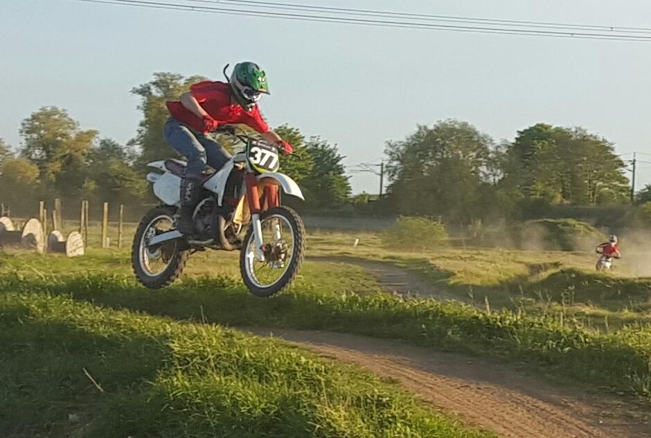

this is my restored 1988 dt125r field bike. obviously this is not me in control of it its my brother lol im just the mechanic

Got any better pics of the bike looks good from what I can see in the picture. Have you gone completely stock running wise ?
for some reason i cant get any more photos on:(.  But the engine is completely stock it has just been fiddled with like where the air/fuel mix comes into the barrel the two little 'fingers' if you like have been completely rounded off using a file so it flows through better and that made a noticeable difference, i have also messed with the carb a bit to give better performance other then that it has a dep exhaust system. As for cosmetics i had the frame powder coated and the front forks painted white as well as the triple clamp which i think looks much better. i tried to keep it as original as possible but with a few tweeks of my own. it is actually for sale on gumtree listing :1124412462 where there are better pics tooB)

Great shot with your brother in the track. It also gave me some plans in creating a supermoto project. I envy you guys.
