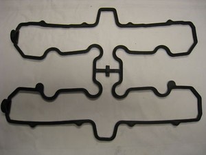

so first, tasky, I saw I have oil leak on the valve gasket (I think this is the correct name) is the rubber thing in H. I do a search for 1992 FJ1200 3XW but the ebay confuse me so I don`t know what exactly what I need. you say you have the same model, can you help me find out what gasket I need?

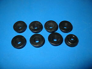

You need a "Valve cover gasket" plus don't forget the rubber "O" rings on the 8 bolts that go through the valve cover. These things 8x-YAMAHA-FJ1100-FJ1200-VMAX-XVZ12-FZR600-FZR1000-XJ700-VALVE-COVER-BOLT-SEALS

the o ring seems to be ok slice but the valve cover gasket, because of the heating has become in a corner more like a plastic. this is the gasket I speak about slice but I don`t know is is the same for all models, I see for some models on ebay but nothing about 3xw.
Ah I see ok then try here http://www.wemoto.com/bikes/yamaha/fj_1200_3xw_type/91-96/picture/valve_-_rocker_cover_gasket_seal/
That will give you a gasket for your exact model mate. £37.58 is an about average price, if you join the FJ owners club it will be slightly less but you have to pay a joining fee which will make it more expensive. I would change the "O" rings as well cos if they haven't been done then they will leak eventually and you might as well do them while the cover is off now rather than wait till they do leak.

The H-shaped thing is officially a "Cam Cover Gasket", although may also be called a "Rocker Cover Gasket".
FJOC does them for £23. You will need the joining fee, but it's worth it if :
