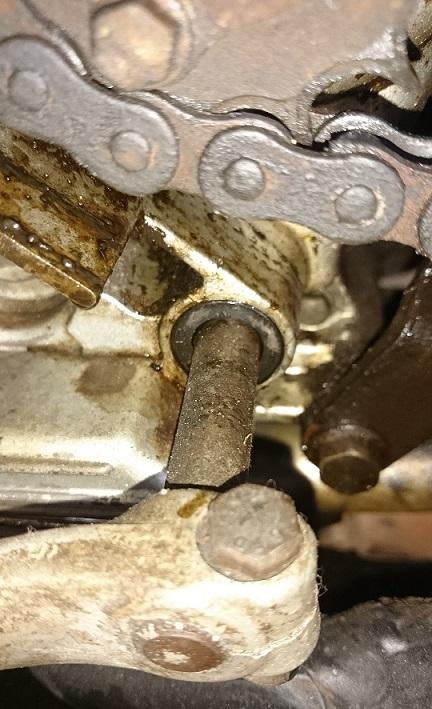

Hi, first of all im useless with the technical names for parts (amateur lol) so excuse me, but I would like some help changing a seal that leads into the gearbox from the gear changer if that makes sense. Ive bought the seal I just need to know how to get the old one out, see pic.
Thanks.
Never mind, fixed it.
Took the gear lever off, got a knitting needle with a hook on and pulled the old seal off.
Good clean stuck the new one on and replaced the gear lever , sorted.
