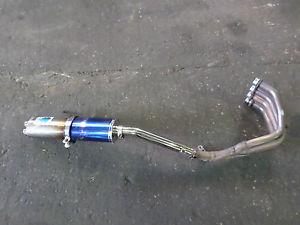

If you have bought it, can you not line it up to your bike and see? as long as the header mounts fit and the angle of the downpipe doesnt graze your frame etc, then I cant see it being a problem... as without knowing exact dimensions of the one your bought, then its a little tough.
Be aware though, even or OEM parts, you need to put a certain amount of force into fitting new header pipes as for some reason, they are always a few mm out.

thanks pal going get my mate 2 fit for me see i keep ya posted looks cooler than a standard exhaust for my 600r
true, just make sure you get new exhaust gaskets before fitting. I would get 6 (2 spare) and be careful with the bolts from the manifold, as they become weak over time.
if they wont budge, heat them  up with a plumbers torch, then put cooling spray on them to break the seal. But be careful as you dont want to crack the block near the ports. :)
Will want to see pickies when its all fitted though
