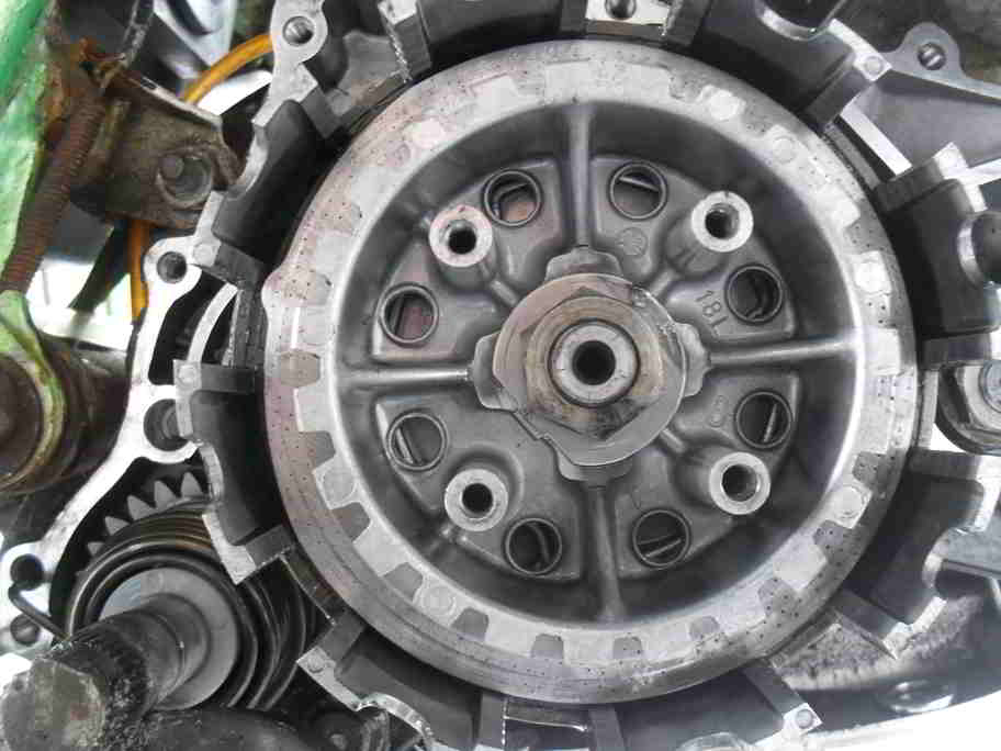

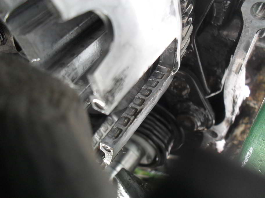

Ok it's apart, plates separated very easily but the clutch basket looks fairly grooved. Is it ok to file them down, what are the drawbacks with doing this. A new basket cost $350 aud.
That must have rattled like a bastard, as above, out with your file and have at it, you could see what it would cost the fill the tracks with new material and then file it back to original, if you know someone with a welder and the skill to lay down a descent seam then you could get it back to original.

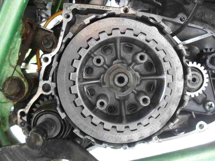

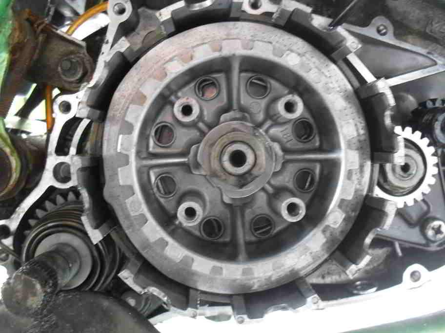

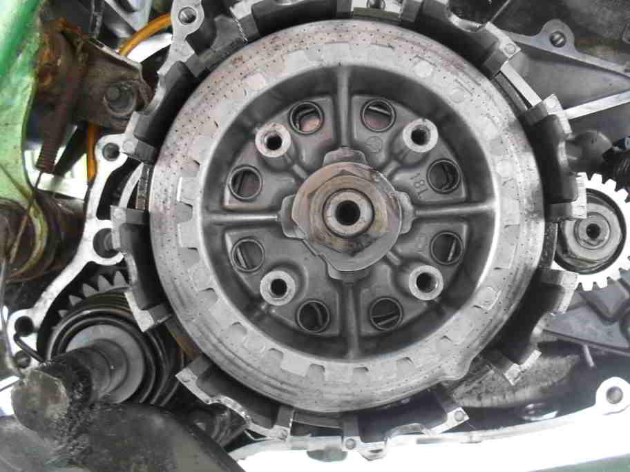

I took some photos of the steel plates during disassembly, if i understand what your saying then these plates are not positioned correctly.
The pips are the single bump on each plate? In the 1st pic the pip is around 1 o'clock, yes?
yIP. your  getting there,  friction plate ,then steel,  mind the pressure plate,  [ outside one]  move it round till it fits proper,
Edited by blackhat250
Yep those 'blips should be 120 degrees apart, (at 12 o'clock, 4 o'clock and 8 o'clock).
When you file them smooth finish with a swiss file or wet and dry. If you don't leave them nice and smooth you may as well leave them be.
120 degrees? i got 5 steel plates, should'nt that be 72 degrees apart as airhead said ?
Im quoting the manual. If you want to try and get 72deg crack on.
ok, got hold of a manual. I've actual got six plates which lines up with manual which says to space them 60 deg.
