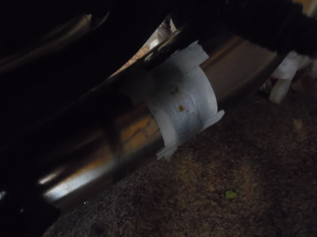

Then sorting the sidestand as its already hammered the chrome off the new pipes. Quite a mission as bolt broke off..couldn't drill it out so cut out the section of frame to get sidestand off..then still couldn't drill it so cut off piece of sidestand. Found new piece with existing hole..cut to size..welded onto stand and welded new nut onto the back. Sidestand repositioned now to miss exhausts. (Touched up damaged chrome with Hi Heat Silver paint)
