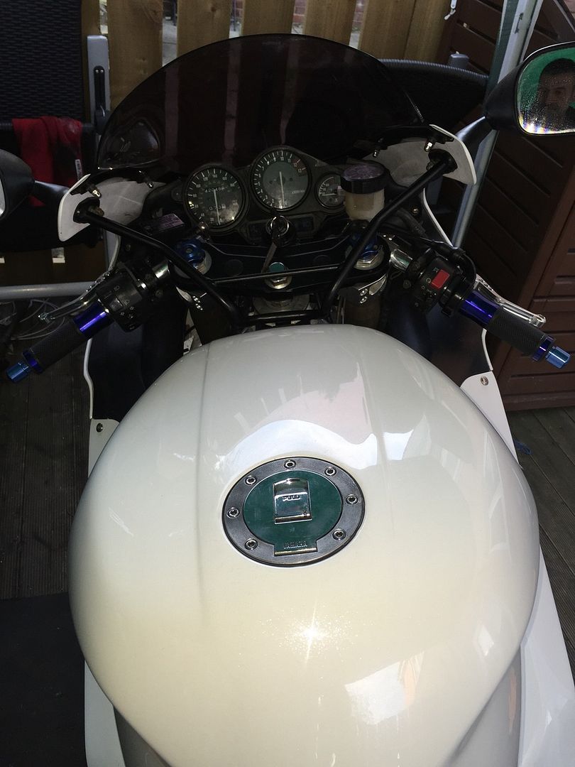

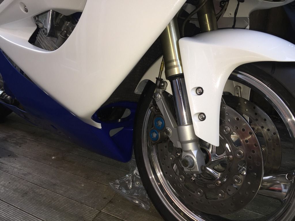

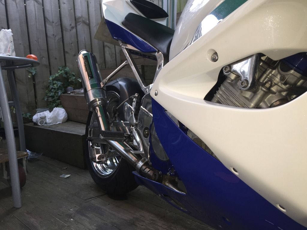

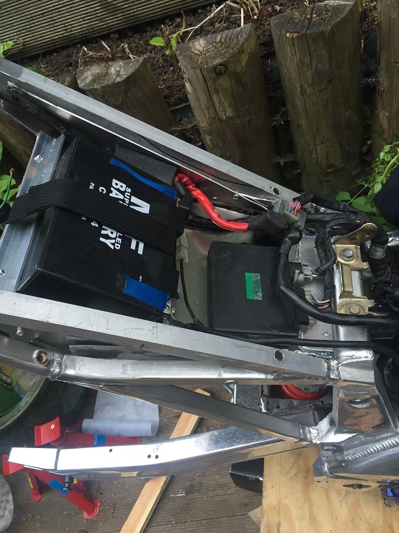

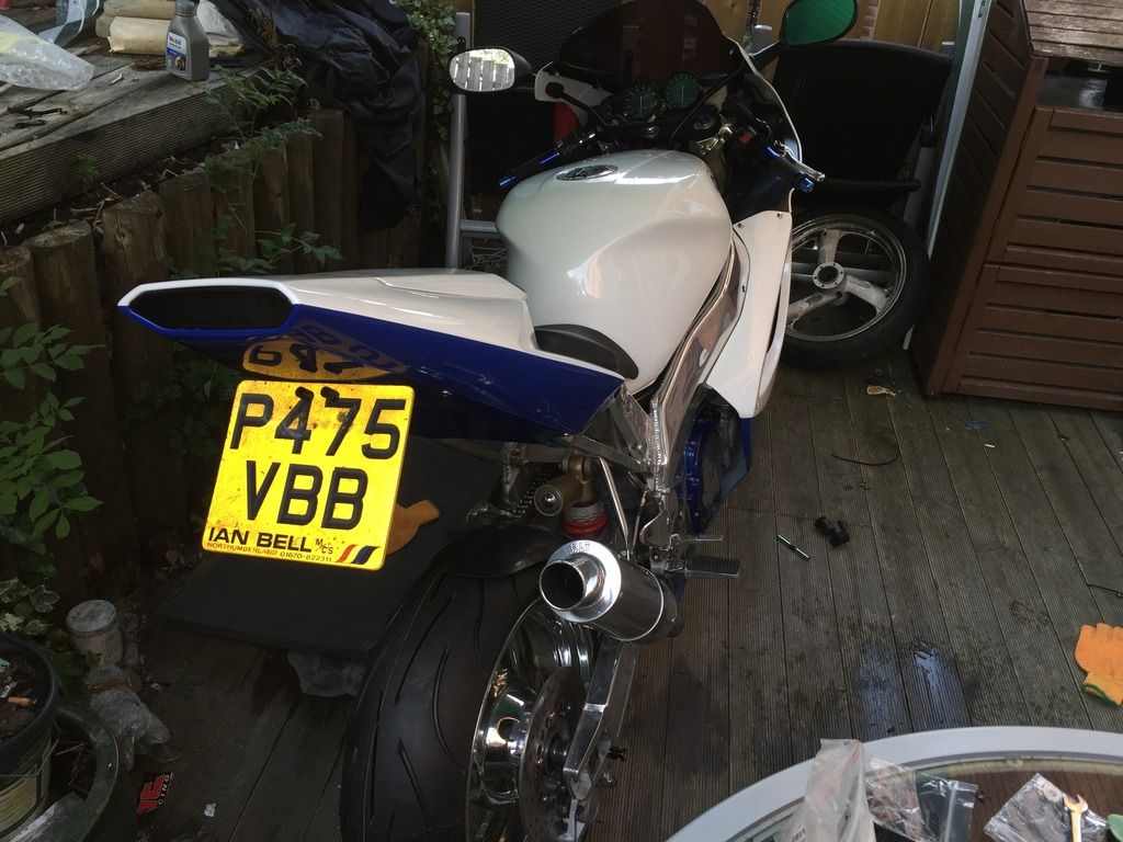

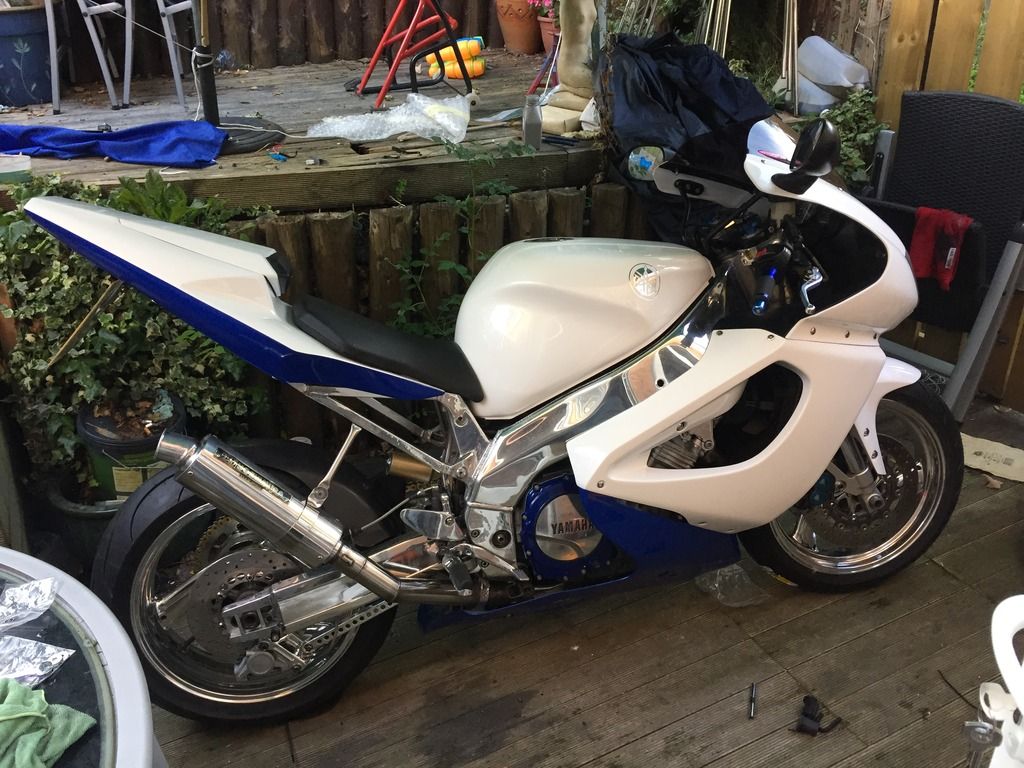

Posted June 6, 201510 yr Started with a standard Thunderace but after some old bloke knocked me off, a project has developed... Subframe cut and welded For the R1 5PW tail Tank re shaped for the new seat Fairing panels slimmed down R1 forks mated to FZR1000RU yokes ZX12R rear shock and Ducati dogbones Sent from my iPhone using Tapatalk
June 6, 201510 yr Moderator You won't get any road spray with that rear end...! that's why i have the missus as pillion

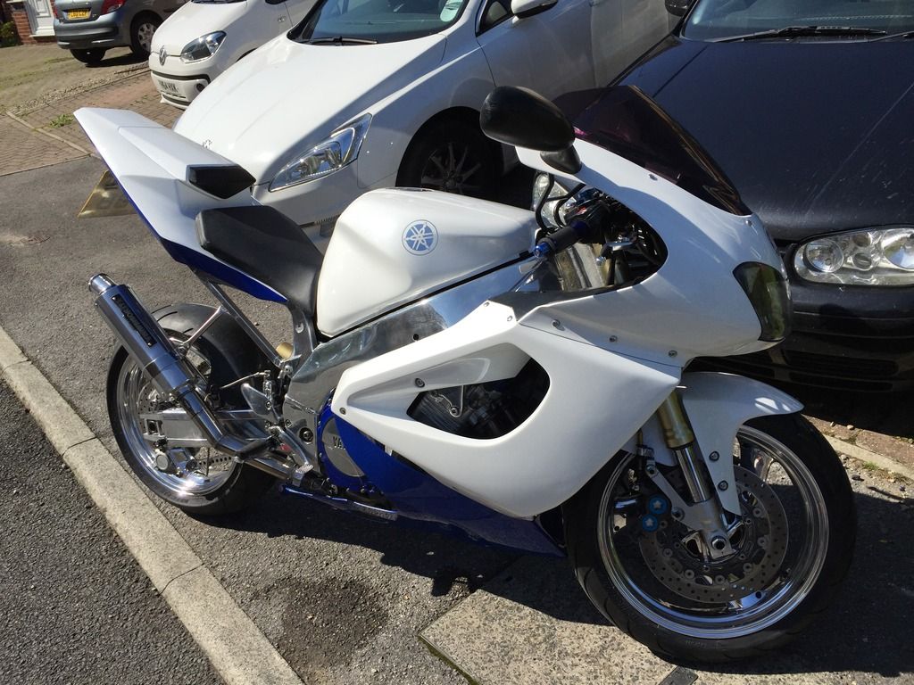

June 7, 201510 yr Author You won't get any road spray with that rear end...![/quote Won't get any with this... Sent from my iPhone using Tapatalk
September 6, 201510 yr That looks like time well spent Paul, Nice result, now you need to get out and enjoy it.
September 9, 201510 yr Author It's surprisingly comfy, and handles much better than standardSent from my iPhone using Tapatalk
September 10, 201510 yr A job well done Paul, you must be well chuffed. Now all we need is the video of it taking off.
September 10, 201510 yr it may just be me , but that massive tail don't do it for me.everything else has the WOW factor.
September 11, 201510 yr Well done fella, I couldn't do that. Though I'm with up.yours with the tail, but each to their own
September 12, 201510 yr Oh no, I've started something now. I'm sorry Paul.But to be fare it does Give it character. Edited September 12, 201510 yr by up.yours
September 13, 201510 yr Author Tail is off an R1 5PW, and whilst it is a tad higher than I intended, it needed to be at that angle to house the battery and electronicsSent from my iPhone using Tapatalk
