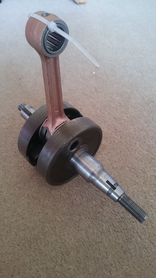

Hee  "  brilliant,,,,,,:lol:
And oil on lounge carpet too
