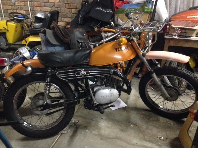

few crappy iphone pics
picking up the new seat from the post office tomorrow.. .really have to get around to painting the cylinder/head.
She's coming along. :thumb:
Thanks. She's pretty rough and ready I mean all the black rim and frame paint is sprayed on with minimal prep and looks good from about 1m but not up close. The green paint I've done properly so it will look good but I figured if I like the bike ill powder coat all the frame stuff black and get new rims etc as the front one is actually fairly buckled lol.
I'm happy cos i haven't emptied my pocket into something I won't get back.
It's a blast even with a slipping clutch. I think it'll be great. The brakes are surprisingly good.
