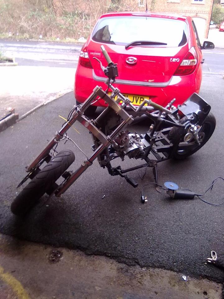

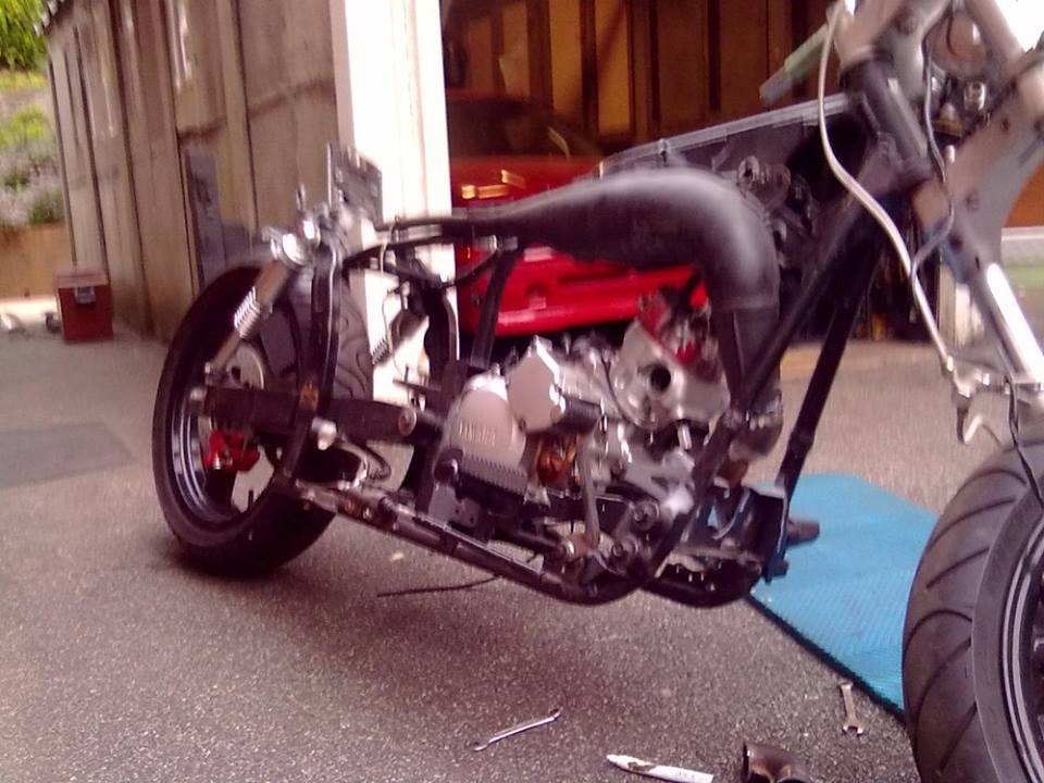

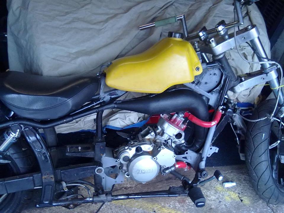

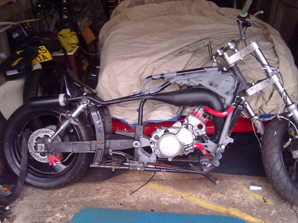

http://i84.photobucket.com/albums/k3/dan25_2006/13094118_10153747221817746_510617089900465825_n.jpg I can only acess this forum on my pc my mobile says it can nt connect to server so I don't come on here as much
these are old photos the engine shown is scrap an just used for mock up purposes
I ve changed the end can to a dep an changed the angle in the process of making a bliltwell seat fit too
