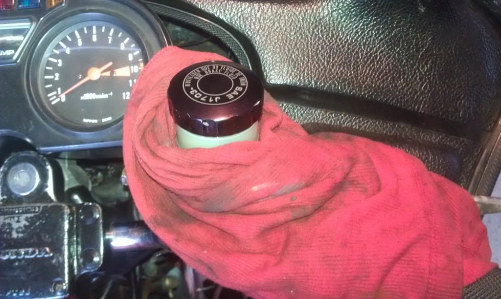

1 wrap the area around the M/C with a rag.
2 remove the top and drain the fluid, i used a syringe. and dispose of fluid

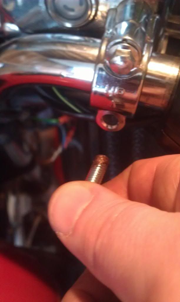

3 slacken the banjo bolt, green arrow, then loosen the clamp bolts, red arrows.
4 then completely remove the banjo bolt, taking note of the two washers, green and red arrows
5 then undo clamp bolts and remove unit from bike, carefully. and empty out any remaining fluid into a container

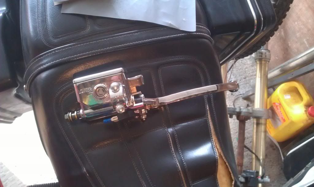

the replacement unit
clamp new unit to handle bars. not copperslip, anti seeze or what ever you want to call it.

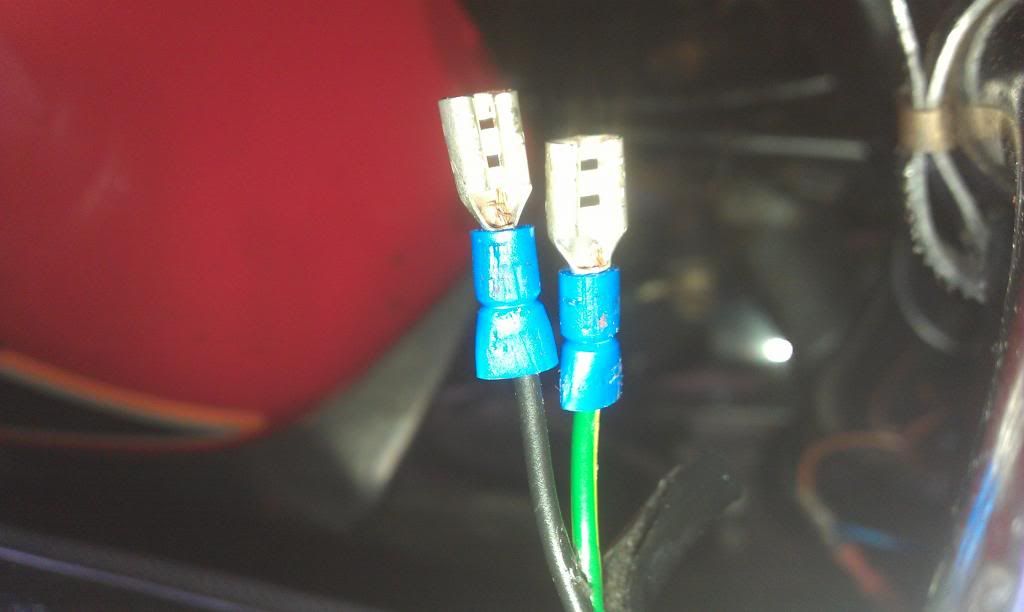

fasten banjo bolt up, i got a new one with my ne unit. then make sure you hook up the spade connectors to the brake light switch.
