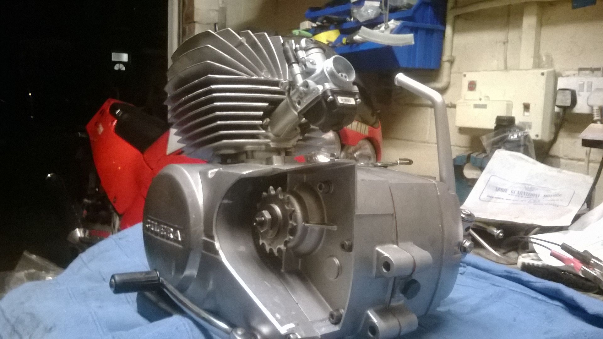

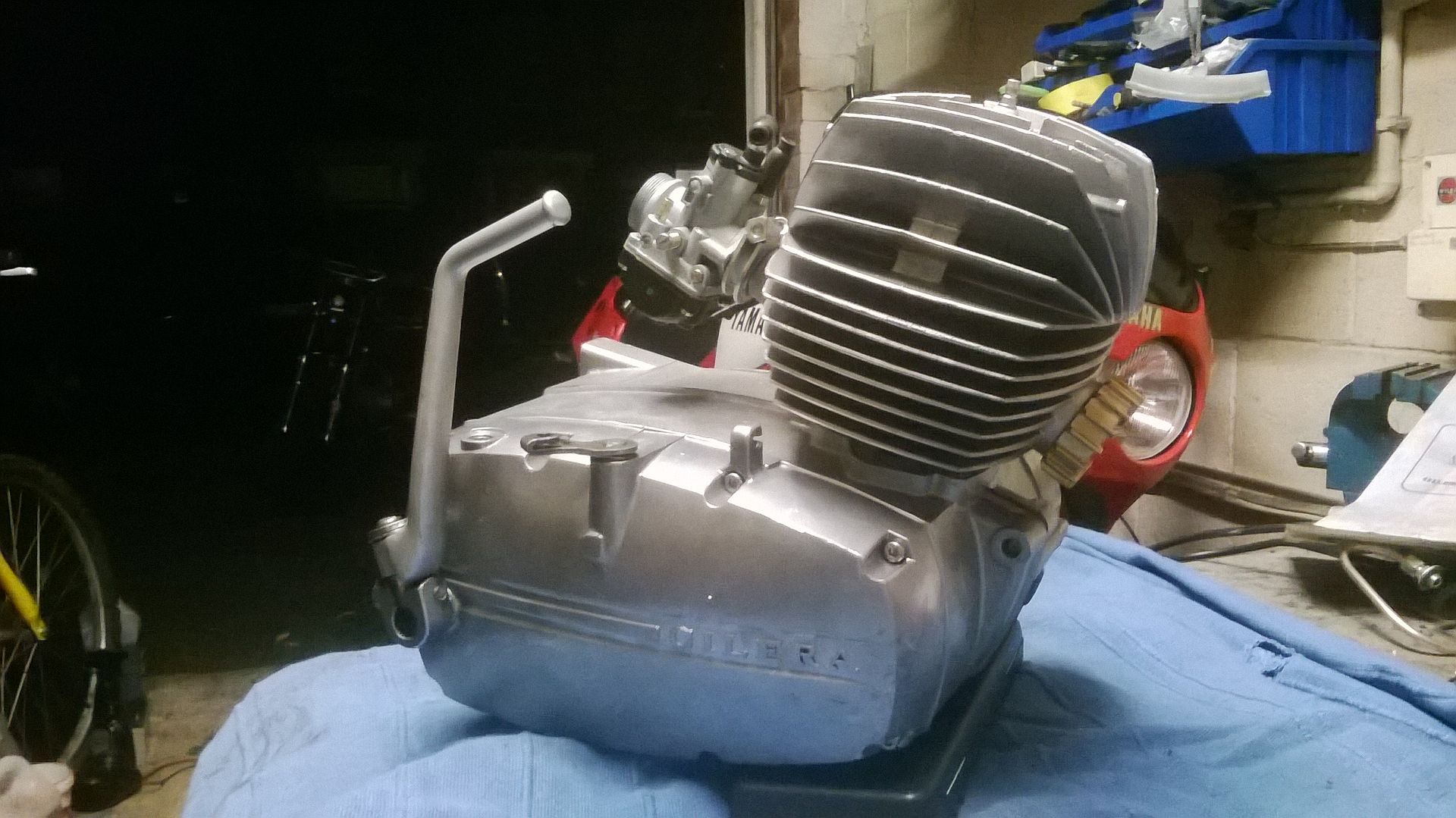

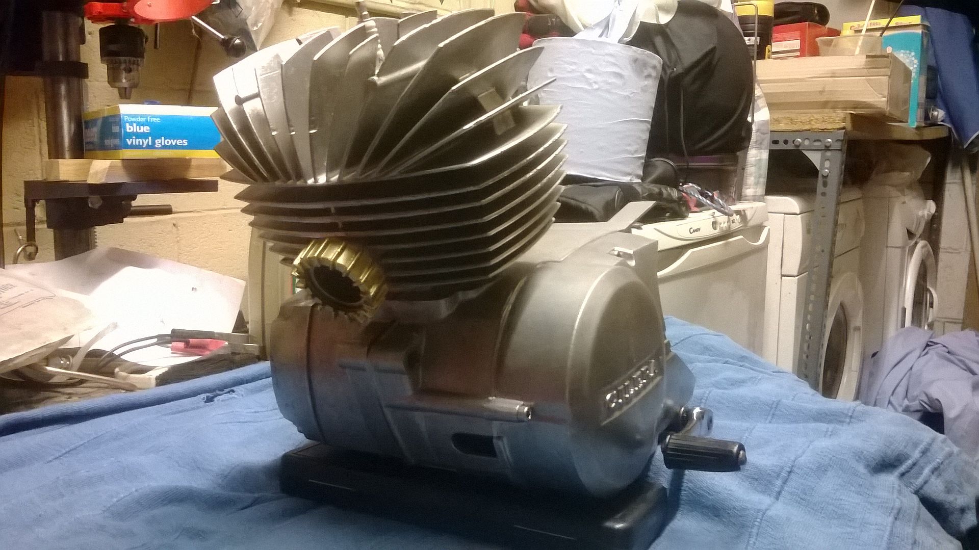

built the bottom end tonight and loose fitted the head and casings for the photo's
just need to clean the little clutch, tighten a few things up, then work out how/where to time the AM6 mag/electronic ignition, sort out squish band etc etc
Looking Good Drew
Yeh thats a "cool" :icon_cool: radial finned head,,,,looks like the Maico"s of the 1970"s
take the head off and there's a tiny hole for the piston :D
