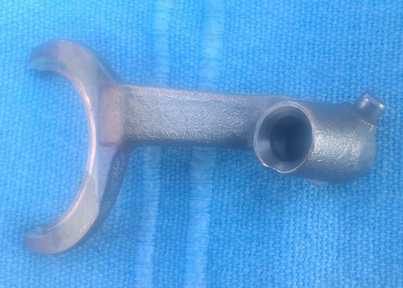

I also noticed the new 5 speed cluster has a blued fork selector, can I reuse this or is it best to find a better part?
blue-5th-gear-fork-selector_zpsb3a327a1.

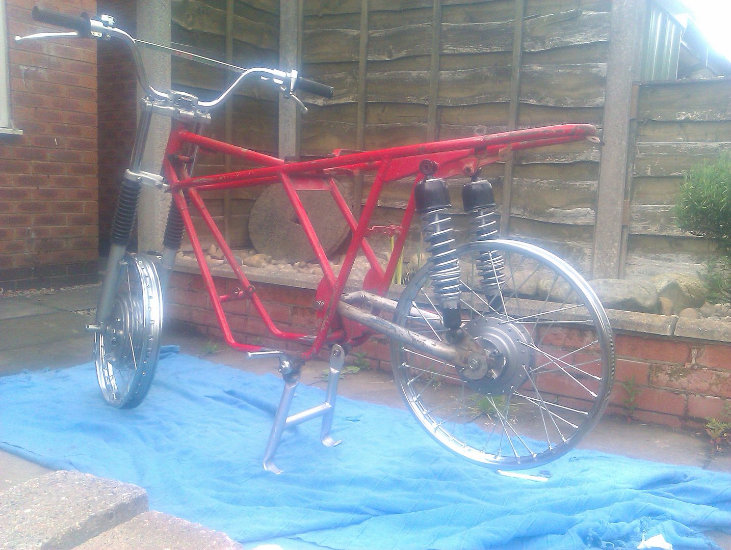

well things have moved on a bit more;

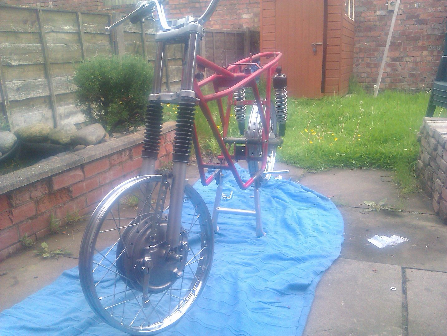

tool the seat to Matt in Hyde to get it covered and I picked up my wheel from Manchester Xtreme
looks ace
rear view (makes the rear seem larger)
not sure whether to go for a traditional ribbed front tyre or go modern and get stickier, I'm leaning towards sticky ATM

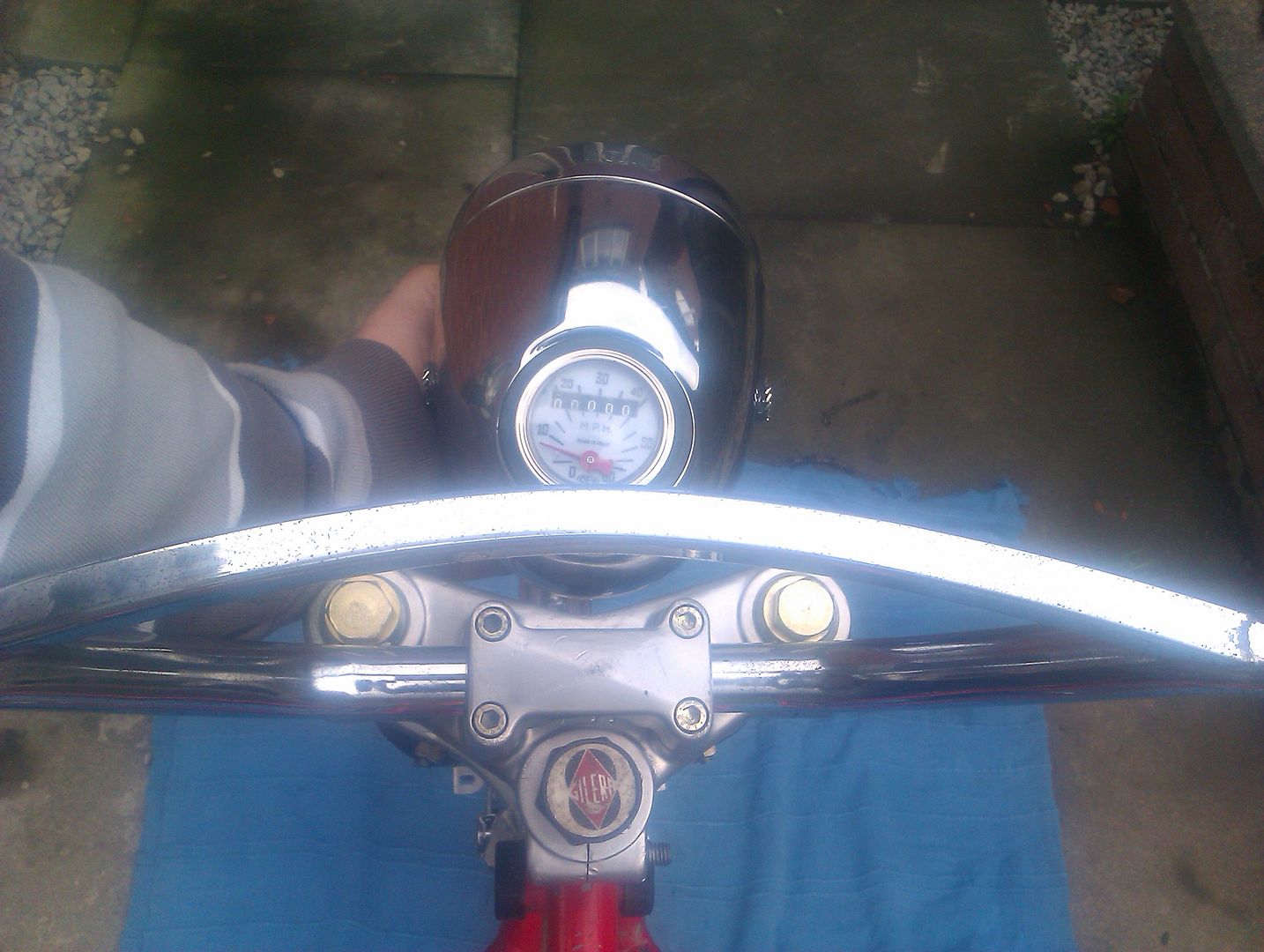

and I also eyed up the headlamp I'm using
that's why I needed longer fork ears
still got about £500 to spend on this yet :eusa_shifty:
that's going to be a real stunner drew you've change my way of thinking here, co's the was a time not so long ago when I wouldn't look twice at a 50cc bike, and when I first seen this I thought to myself Why? but now I'm beginning to open my eyes
can't wait to see it finished now.
looking great drewpy...keep the momentum up

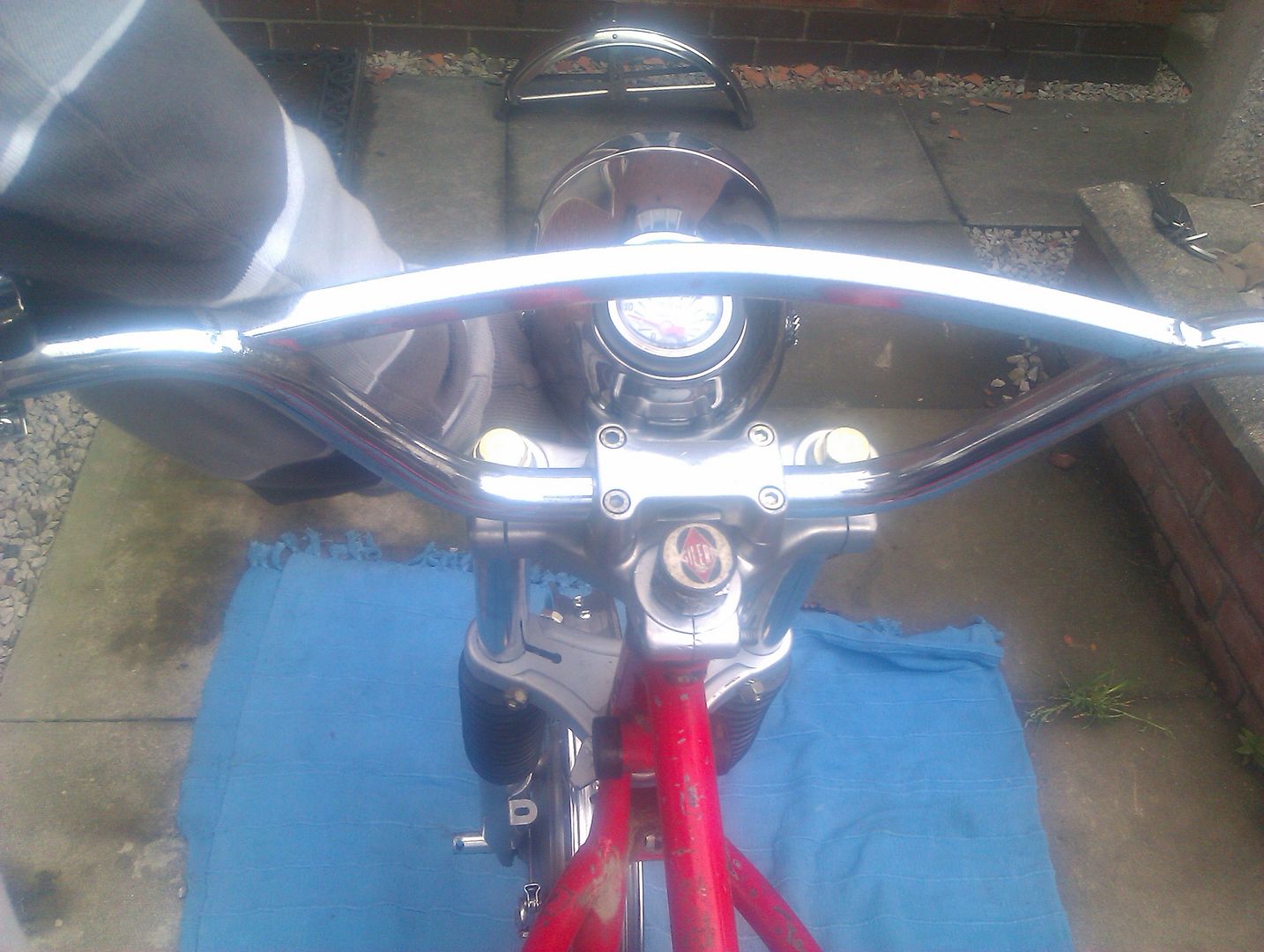

love the handlebar :thumb:

those handlebars are original tomaselli ones and I've kept the patina on them too :D

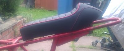

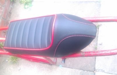

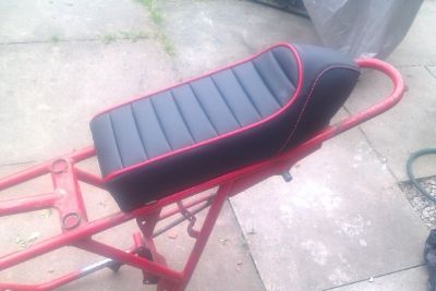

YAY the seat arrived!
picked it up from Matt Caulfield and it looks great, see for yourself
259cc529-ea4b-4f8b-bd03-ee0376090a08_zps
:D
Ooh that does look sharp!
another piece of the jigsaw lookin good drewps
came out just as I envisioned.
project stalled now as I need a 5th Gear selector, and time and money......
i take it that self-fabrication is out of the question?
I don't have the facillities but maybe I might have to get someone to make one.
