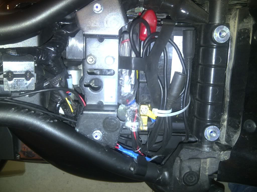

just out of interest where have you placed the rider and passenger sockets on the bike

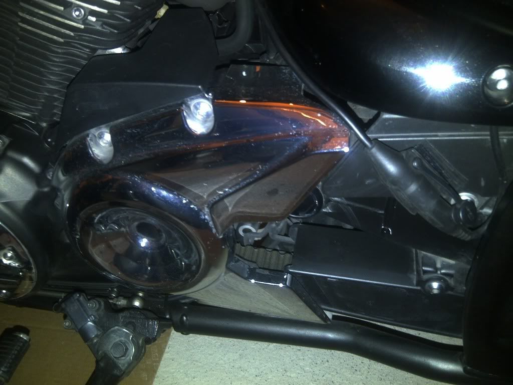

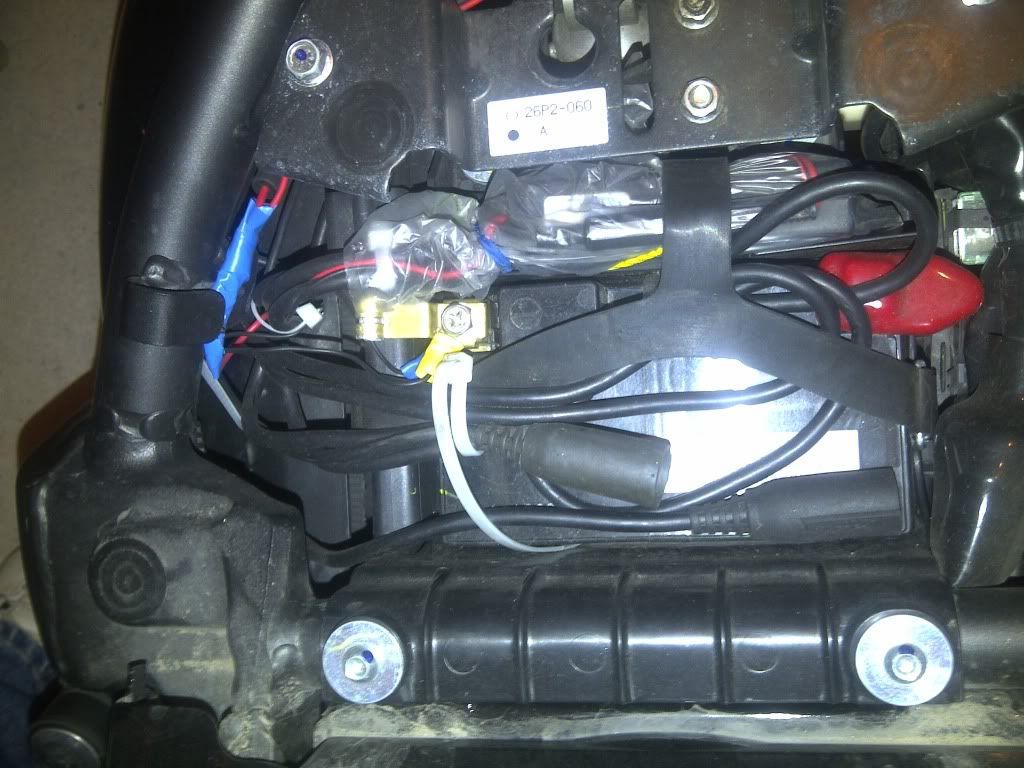

Ok so the unit is actually in a plastic bag down the side of the battery lol

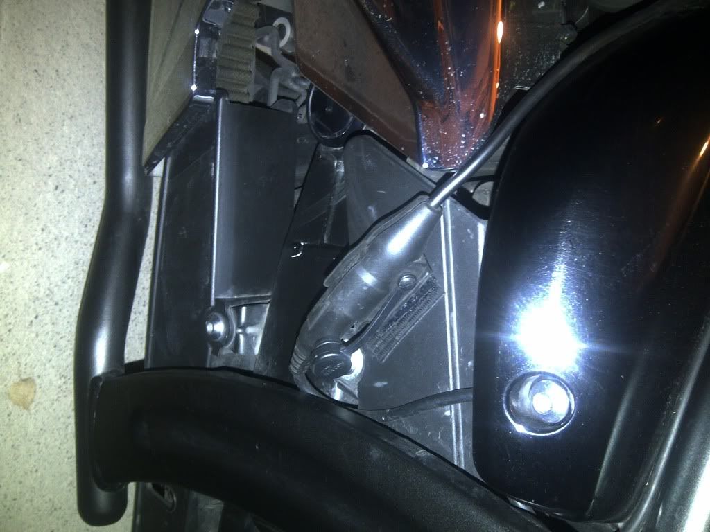

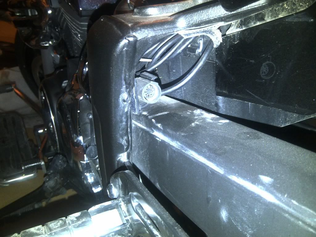

The cables then run to the left, with the driver cable running to the tank, then out under the left.
Passenger cable comes out just in front of the pegs.
Looks like the cables have then temporarily gone back under the seat for storage. Haven't used them since last summer so can't remember the exact set up at the mo.
I feel like a real ploncker now :hyper: , It never acured to me to put the main unit in there, it looks like it was made for it
I think I may reinstall it at the weekend that way I can put both tool kits on top of the battery
I installed the rider socket on the flat uprise were the overflow pipe comes down it was the only flat surface to stick the socket holder to, but I have to be careful plugging in/out as the cylinder head gets hot (make sure I keep the gloves on)
wiil have to think about the passenger socket though

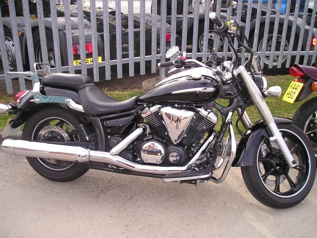

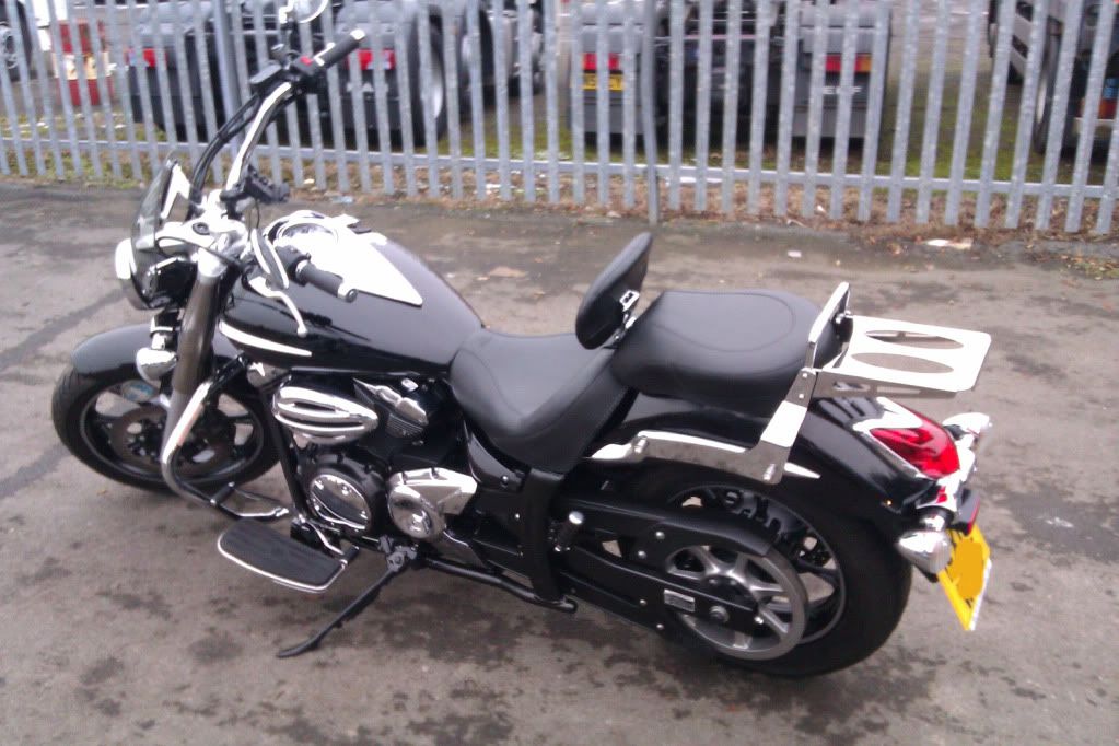

this I have sorted photes out, hope you enjoy them
here is one without the paniers showing ghost bracket stubs old seat

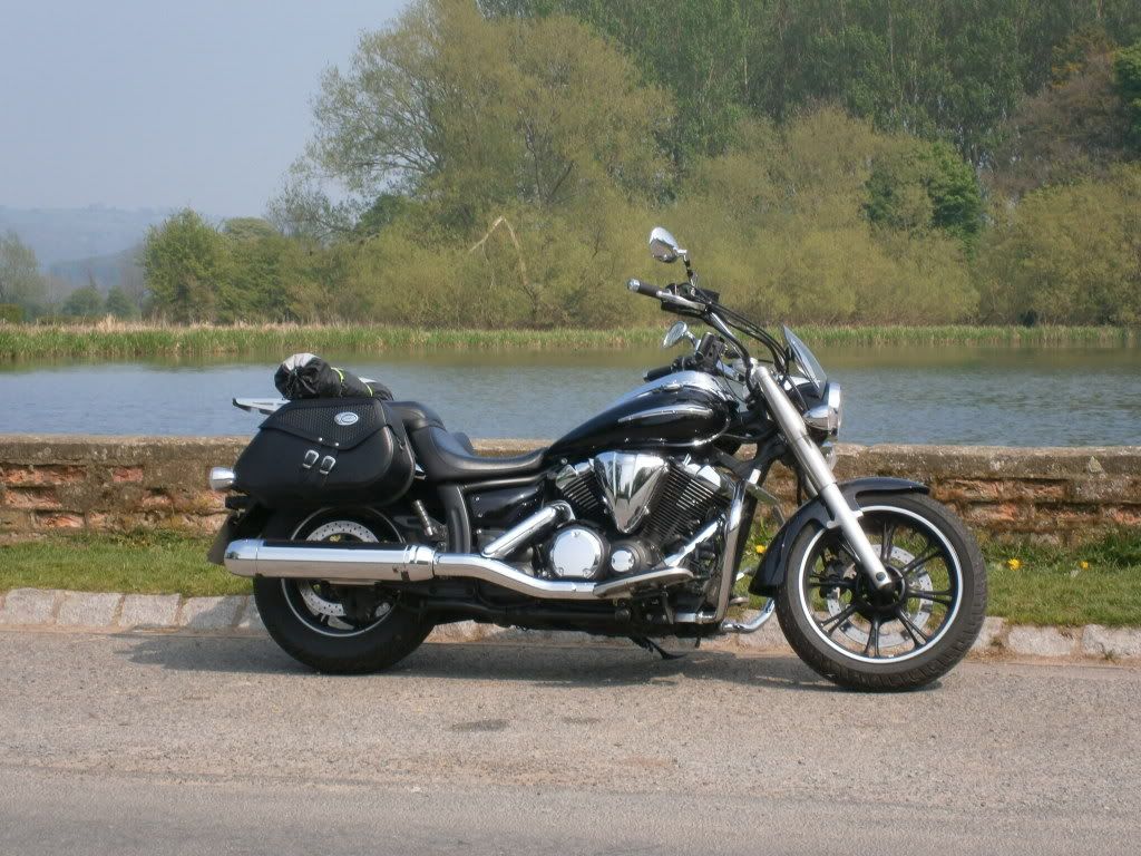

this one is of camping and loaded up Masham norh yorshire
hers the new seat on I just got the bike ACF50 sprayed at the bike club am in
