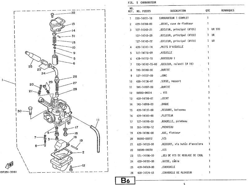

ok so only because I for the life of me cannot figure out how to post a pic without an http link
http://www.bikebandit.com/houseofmotorcycles/1982-yamaha-lb50pj/o/m7364#sch218172
should be the OEM parts fiche for the 82 LB50, on the carb, part number 37 is listed as vacuum hose and come off just in front of a gas line feed.
No idea where it goes though.

VM14 have this look :
There is also a hose at the same place (marked 11), but it's just a venting pipe (often without hose) for letting the float chamber without air pressure.
Hose is here just in case of a fall, to let go fuel under the engine and not on hot surface like cylinder ;)
I think it's surely the same for your carb. Maybe you'll want get off float chamber, blow in this hose, and see if air going out from a little hole on top of float chamber, so you'll be sure this is a venting pipe :)
