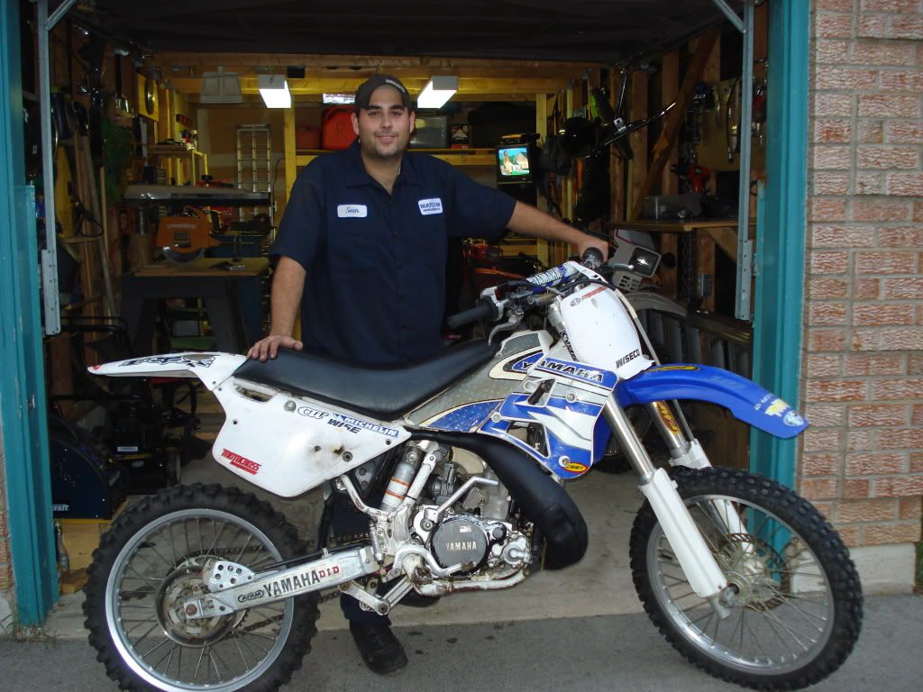

Posted January 27, 201114 yr Hey everyone!!! I need to know if someone on here can help me before i spend lots of money on something i dont need too!! Ok i bought this bike about 3 months ago! Its a 1992 yamaha yz250, when i purchased it she started 2 kicks and i took it for a ride! It would not hit the power band it would bog down when i got to the point of action! He told me it would need a set of reeds and thats why it was doing that! So i bought the bike brought it home and it started for the next 3 days in a row. I left it for a week and then it was hard to get started and now its 2 months later and it wont go at all. I have changed the reeds, air filter, spark plug, cleaned the jets on the carb, changed the gas!!!! Still NOTHING!!!!! It has spark, it has compression i think it was 120 with the throttle opened up... I have even sprayed some quick start in the airbox but still no luck! Can someone please tell me how to get this going I have had it for a few months now and havnt rode it!!! thanks everyone in advance sean
January 27, 201114 yr Moderator Hmm thats a tough one you have done the groundwork, is the choke working? Does the plug get wet with fuel? Can you gather some mates round for a push start attempt?
January 28, 201114 yr Author alright GOT HER GOING!!!!!!!!! i tried everything but one thing. I put some fuel into the spark plug whole and kicked it. Started right up!!! Did that about 3 times and now runs pretty good!!!!! Kinda hesitant when starting in first but then takes of like a rocket thanks guys
