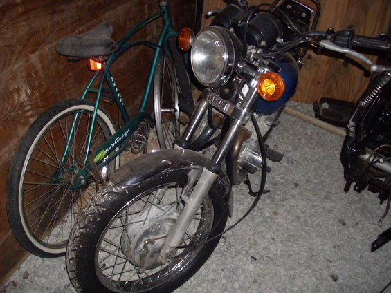

For the front, you can loosen the fork clamps on the triple trees and slide them up. I wouldn't do more than maybe a little over an inch, though. I am 6'3" and I did 3/4" and there is no negative effects and it seems to turn in a hair quicker. For the back, I think the right way is new, shorter shocks.
This bike is more your size, than mine, though.

And @HoughMade Yeah you're right. It's much better of a size for me haha. My friend are all like 5'10 through 6'5 and they make this bike seem so tiny.
